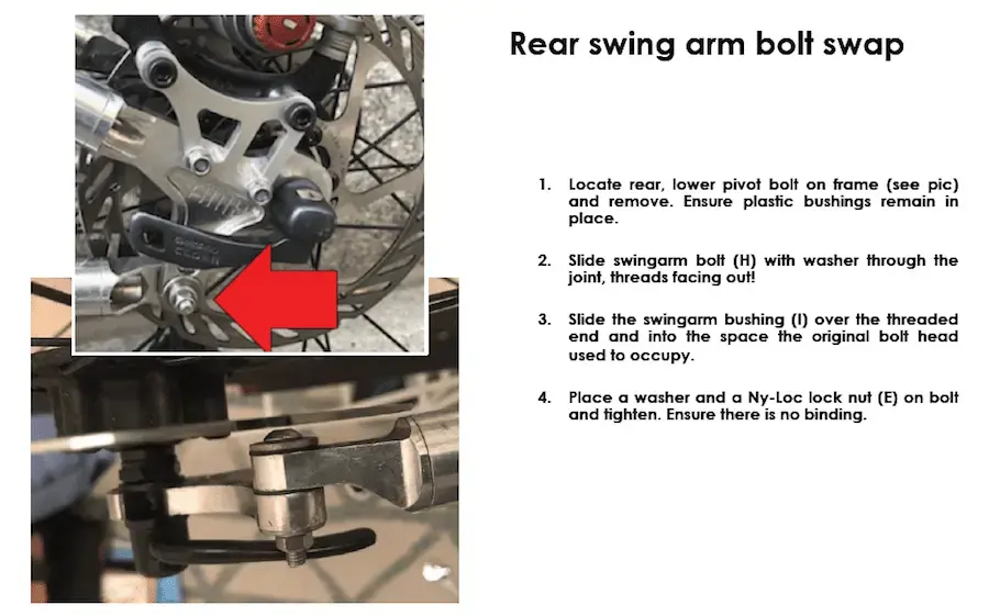

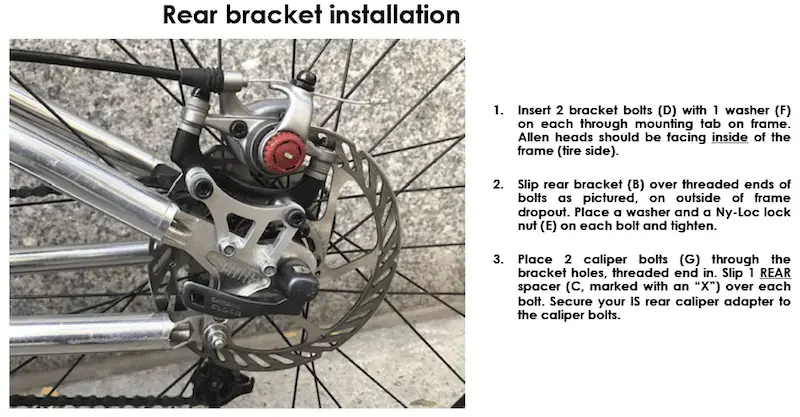

Front + Rear: machined front and rear aluminum adaptor bracket, offset spacers (front and rear), M5 bolts and nuts, caliper bolts, rear frame swingarm conversion kit**

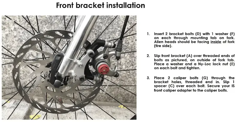

Front: machined front aluminum adaptor bracket, offset spacers, M5 bolts and nuts, caliper bolts
**Swing arm kit is a special bushing +panhead bolt + lock nut + washers.
This replaces the non-drive side seatstay-to-chainstay frame pivot bolt. The original bolt sits recessed into frame and the nut is on the inside of the stay. The nut (at least on my frame) contacted the 160mm brake rotor. To make it work, I removed the bolt and installed a pan head allen bolt in the opposite orientation (insert from inner stay). The bushing fits into the recessed part of the frame where the original bolt head was (to fill the space). Washers and lock nut go on outside of frame. This gave me clearance to run rotors. You may not need it if A. your frame is different or B. you plan to run rear rotor smaller than 160mm.
