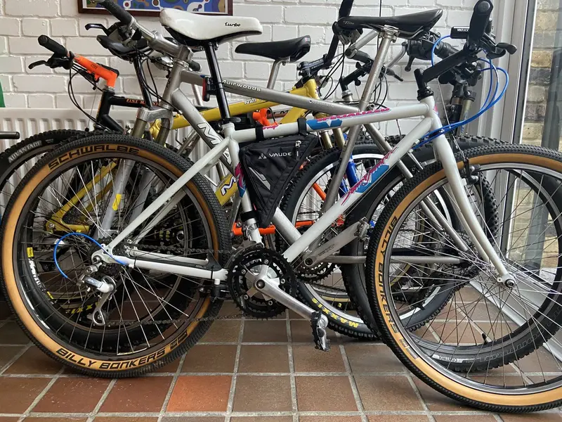

FEE90F8C-4299-4BF1-AC12-30D5F8E7BC58.webp Nice naches with the amber walls. I’m using my daughters stumpie on dry days: 2.1 Billy Bonkers = velvet-lined marshmallows!

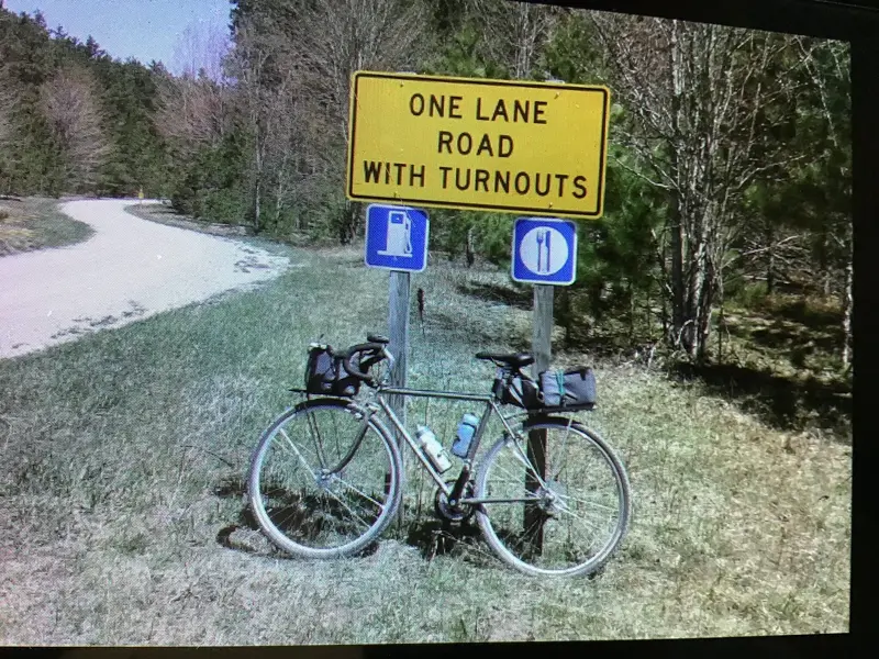

Here is my home built gravel bike. It’s a 1970s Panasonic touring frame and fork with chain stay dimpling to accept 700c x 38 tires. Triple chainrings and 7 speed mega range. Home built wheels using 29er Weinmann rims. Rivet nuts for the frame bottle mount. I’ve had a total 340 pounds on it (bike weight, pack weight and rider) wilderness adventure riding and camping. With the 24 x 34 low gearing I can climb long pretty steep hills with all that weight. The drop handle bars are a must for 10 hour rides as you have a lot of hand positions. A mountain bike stem keeps me upright when I ride the top. It’s got brake lever shifting and cyclocross top brake mounts. Homemade custom fit luggage racks made by bolting and welding old racks and flat stock. I’ve gravel raced it 100 km. I even do a little blue trail mountain biking with it. I have ridden 50 mile road pavement rides in the spring on it. It does everything pretty well. If I was limited to one bike, this is it. image.jpg
