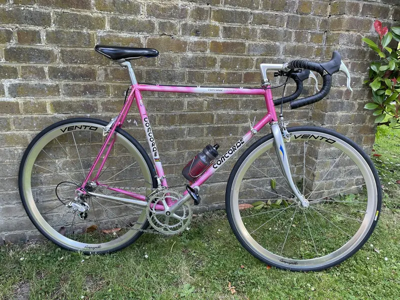

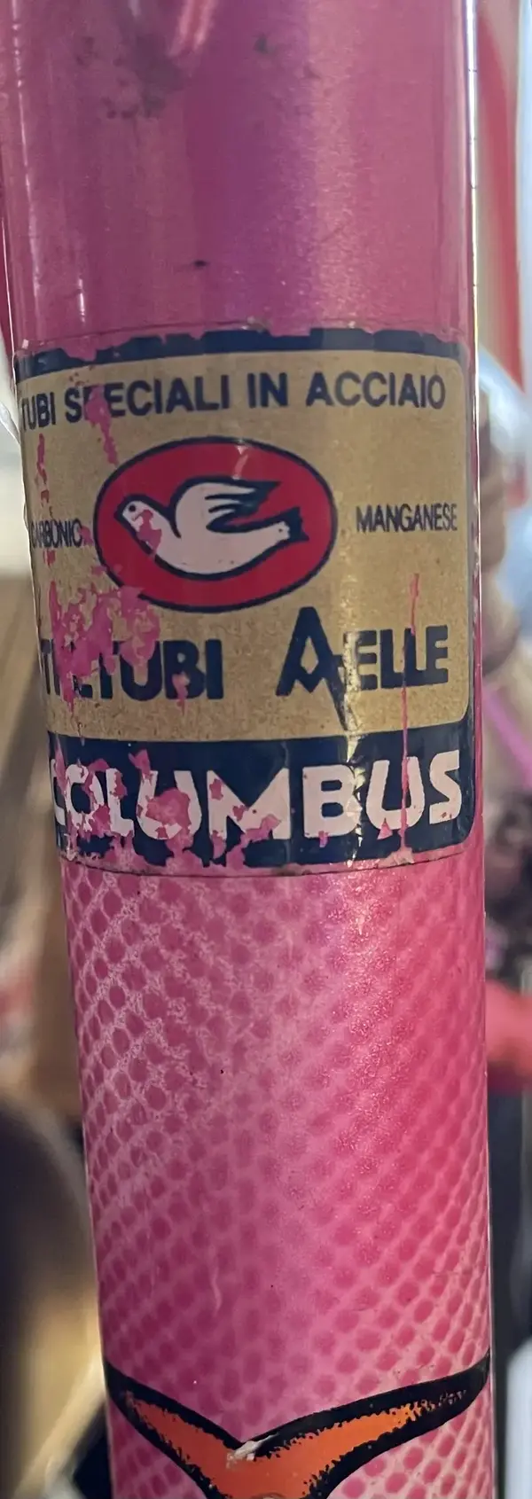

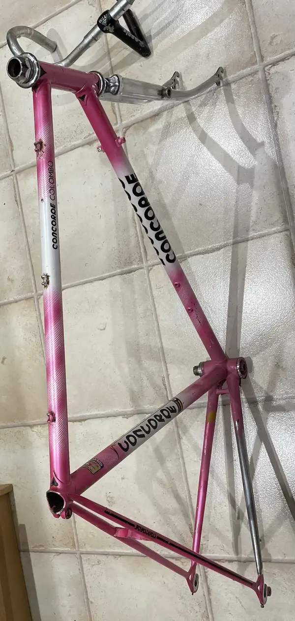

Hello Everyone, I have recently purchased a Concorde frame which I plan to build up with Campagnolo components.

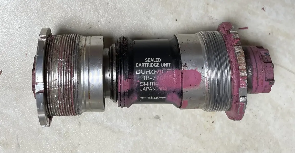

The frame had a Shimano Bottom Bracket, partially fitted, I've removed it so I can install a Campagnolo BB. I believe the thread is Italian, the shell measures 70mm.
My question is which size BB do I need if I plan to run a Record double chainset?
Thanks in advance

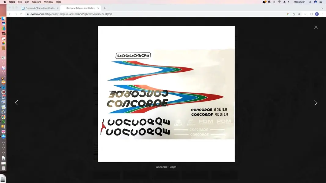

Cyclomondo has the 1990 PDM decal set - the newer version with the black head tube would look great and the external rear brake guides are a nice touch
