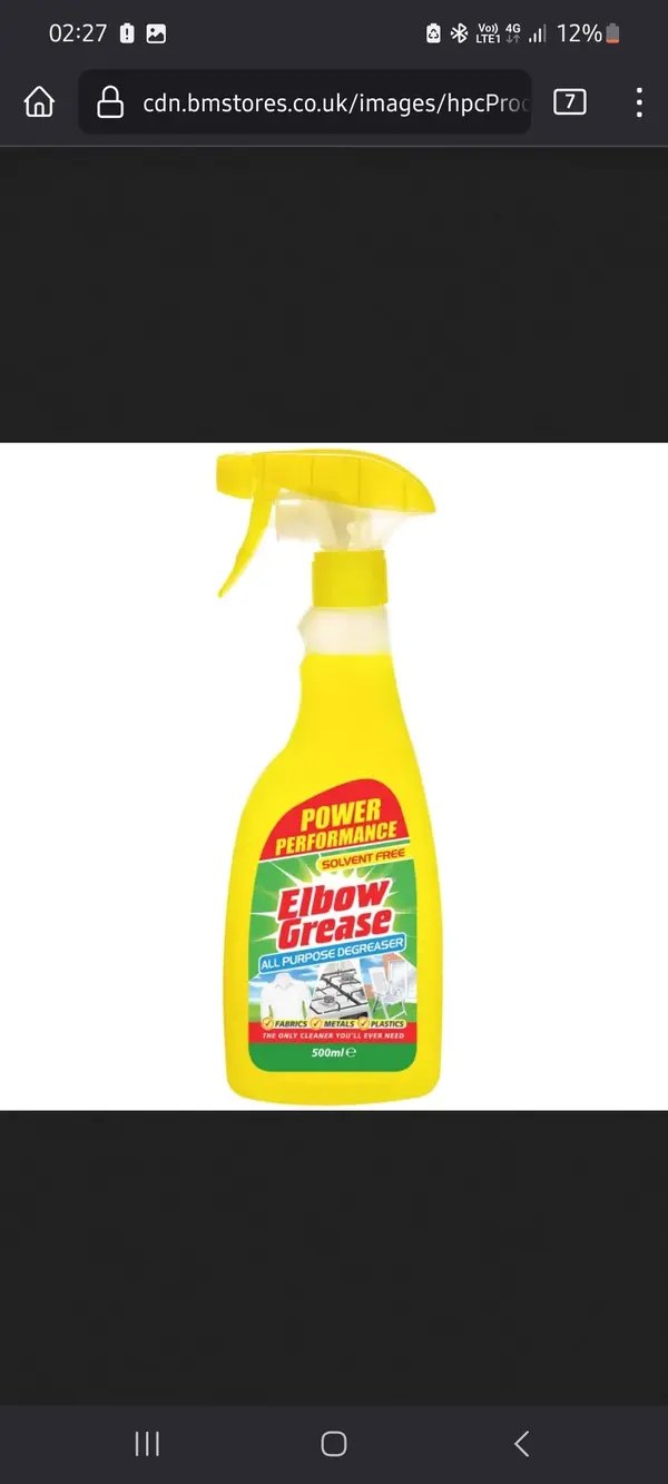

I thought this was a prank product
Me too - mind blown!! (I've just had to order some to make sure I'm not hallucinating)
Edit. And now I've just cancelled that order as I've seen how much it actually costs when you're not lazy and buy it from a real shop.
