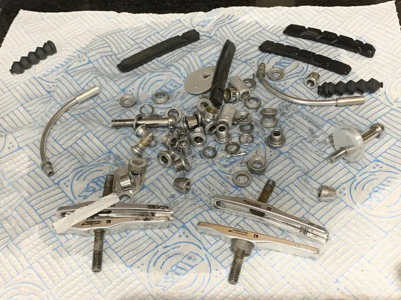

That’s straight out of the jar so not bad. I’ll give them a soapy rinse. Pads want binning I know 👀

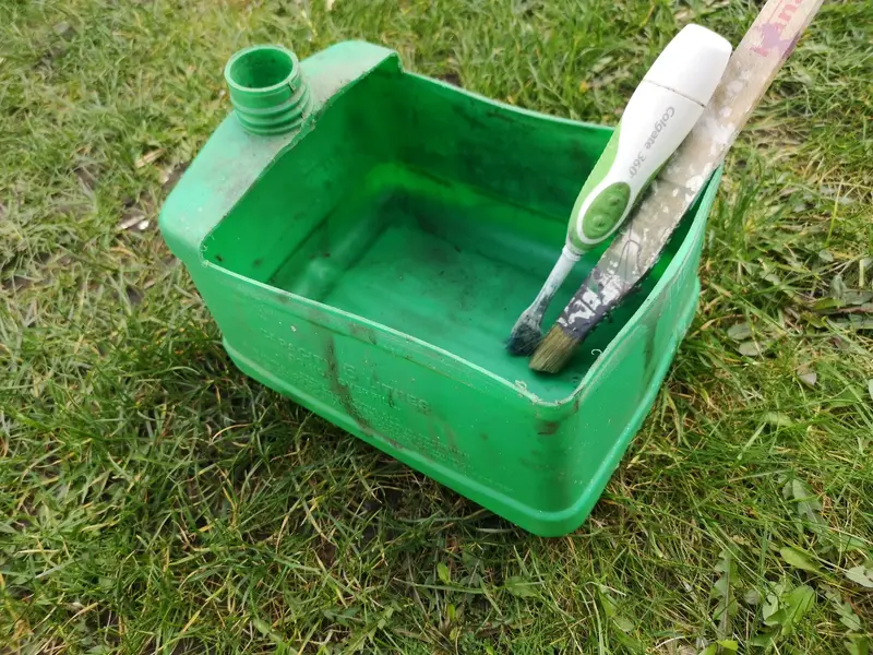

A few years ago I only had room for either a sand blasting cabinet or a parts washer, I went with the blast cabinet. Old gerry tin above is what I use for cleaning most bike components. Leave the spout on and you can pour your solvent back into a tin for future use.
