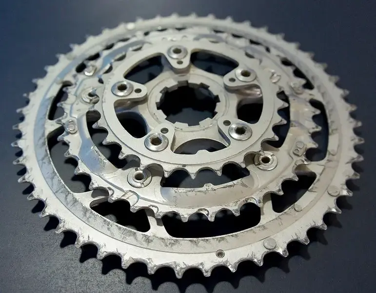

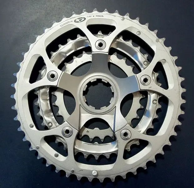

I do have the spider plus chain-rings. They shift fine I took them off my commuter bike two weeks ago (replaced the XTR cranks with a set of Sweet Wings), certainly not mint but work OK. Attached are some pictures, let me know if you're interested. I like the look of the 5 arm spider-chainring combo way better than the regular XTR 4 arm set-up.
The rings are 48!-36-26 teeth.

That does look like a good solution - and I'm interested in the spider and rings (subject to asking price delivered).
syncrosfan":fj9wvrpg said:
I do have an original M952 5-arm spider (ca. '99, look at their catalog). This one allows you to use regular 110/74 BCD rings with the XTR cranks, and those size rings are still readily available. Let me know if you're interested.
