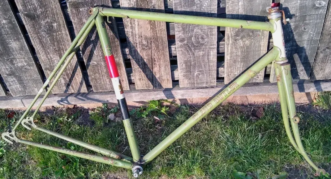

Hello I am honestly quite new to vintage bikes although I am getting quite vintage myself... bit of a late developer. I have recently bought a frame for a Claud Butler European. The serial number is 22840 and it is stamped with CB on the bottom bracket which make it a 1957??? I think. My question is am I right and could this be one of the last bikes to come out of the Clapham Manor Street CB factory. Also I have found the CB catalogue for the European but does anyone else have any information about them.
Thank you and I wish you well.

22840 - just from the frame number page linked above = ? might be 1964?
I have no CB knowledge but like the ride of my Holdsworths - '72 Pro (special order numbered), '82 Special.
Reynolds tubing transfer appears to indicate plain gauge 531
bottom bracket assembly looks to be TDC
front brake hanger may be GB
pleasing! 👍

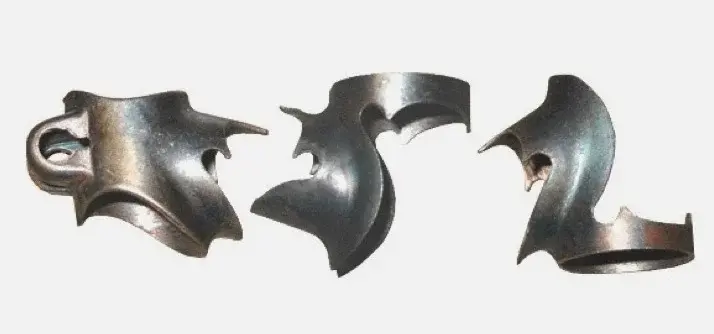

lug pattern Prugnat 62/s

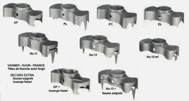

fork crown Vagner model 12
pump pegs Cyclo Ref. 25

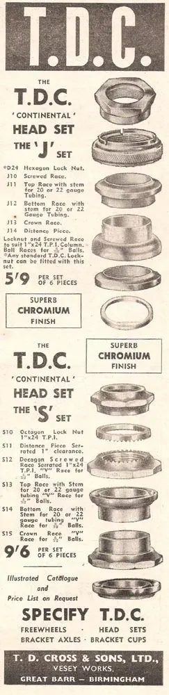

headset Thomas D. Cross & Sons Ltd model "J"

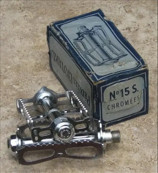

Lyotard model 15S pedals are also easy to find and not costly

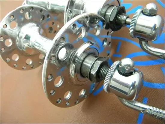

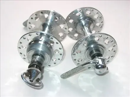

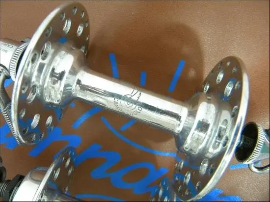

the three-piece Campag Gran Sport hubs of the cycle in the catalogue page are sought after an fairly costly
another period correct Campag hub you could use is the Sportman model, these are less costly
Campag Sportman hub a)  .webp Campag Sportman hub b) .webp Campag Sportman hub c) .webp
