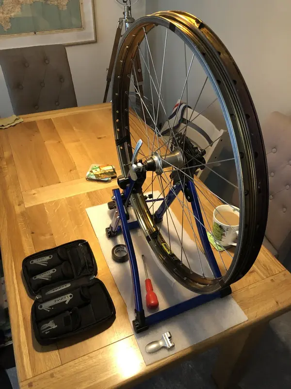

So, I finally gave in and bit the bullet with swapping my none matching rims. An easy one to start I figured, a similar Mavic 217sunset coming off for a Mavic 230TIB going on. Whilst the local bike shop wanted £55 to do a wheel build, I figured it’s something I should try give a go as a right of passage. That and I have potentially 3 to do in total if the first ones a success.

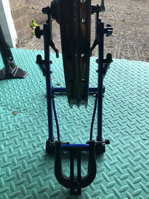

My hope was it would take me Approx 1hr or so to do (I tend to only have 2hrs free on a wknd whilst the toddler naps) and originally I had hoped I could modify my spare P2 fork into a bit of a jig, since if I wasn’t doing it on a budget I might as well be paying the LBS and going For a ride with my time.
I eventually thought better of the diy jig, as rim swap number one was a rear wheel, so the P2 was never gonna work.
I purchased the cheapest one available in blue on eBay at £19

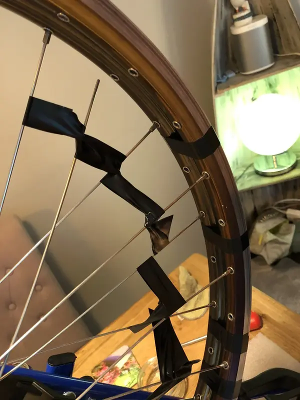

im sure I’d seen an old MBUK grime time thing that suggested: you could just tape the new rim to the old wheel, lined up correctly and then just swap 1 spoke over at a time, like for like. Then obviously just need to bring the dish back in line to centre by like 1inch and true it up, how hard can it be.
(Trying to ignore the pro wheel builder tips of, gotta have new nipples, lube the tips, double check measurements - nahhhh!!)
Postie delivered all the parts last week and yesterday i set to it, decided it would be sensible to do opposte spokes and rotate north/east/south/west to help minimise the old rim and the new one going so far out of true that the spoke won’t reach over to the new rim. Wasn’t sure exactly how much slack was available on the spoke thread.
Step by step pics to follow, then some ‘lessons learnt‘ for anyone else who wants to give it a go for the first time.
1) cut some tape lengths and place ready to hand. Long enough to double wrap the rim, once aligned. (I single wrapped and wasn’t enough)

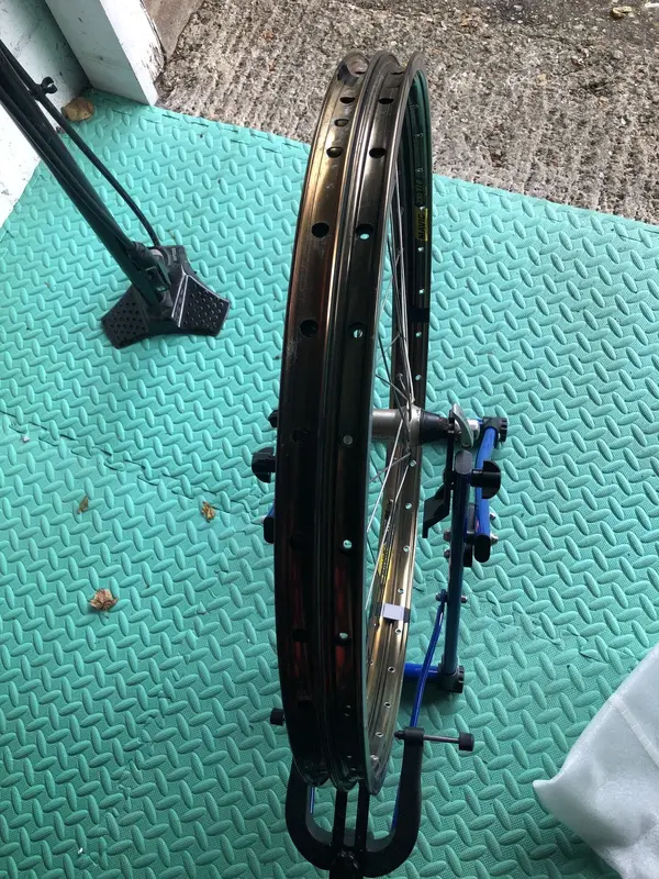

2) line up the matching left & left/right & right facing spoke holes and as you see fit, the hub logo from above, with rim logo below on the floor. (Don’t forget to check the other wheel on the bike so the hubs/rim logos face the same as that one does - if you’re into that)

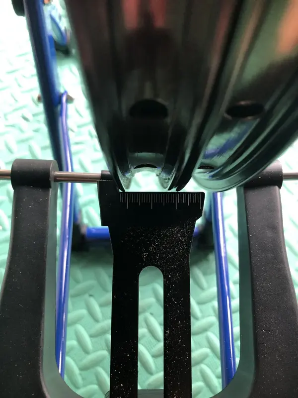

2.1) place wheel in the jig, mark some tap on the stand on one side with where the old original rim alignment should be ready for when you need to dish the new rim back over to centre/straight at the end later.

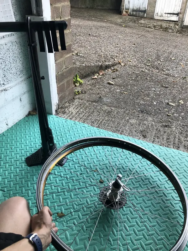

3) the first 4 spokes are the hardest to reach over and as you go the old wheel starts to go out of true so you have to slacken off other spokes to help it stay a bit true, whilst not slackening them off so much that the rim stretches out bigger you can’t bridge over to the new rim.
4) repeat as above, slowly tweaking/truing both wheels a bit to help keep alignment as best as possible, but the priority is to help the spoke reach over new rim.

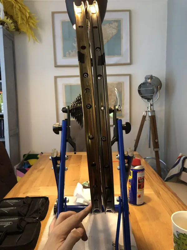

5) as you get down to the last 4-6 spokes it becomes harder, a bit of wd40 on all the spoke threads and nipples helps with truimg. And if they really won’t reach across like mine didn’t, then wrap a bit of tape around them to mark which spoke should go where and free them completely from the old wheel and remove old rim.
6) to get the last 4 spokes in, a bit of jiggery pokery was required to slacken off all the opposing spokes to help the him have the flex to reach the last 4, generally by this point nearly all spokes should be on half thread, and the last few should then reach.

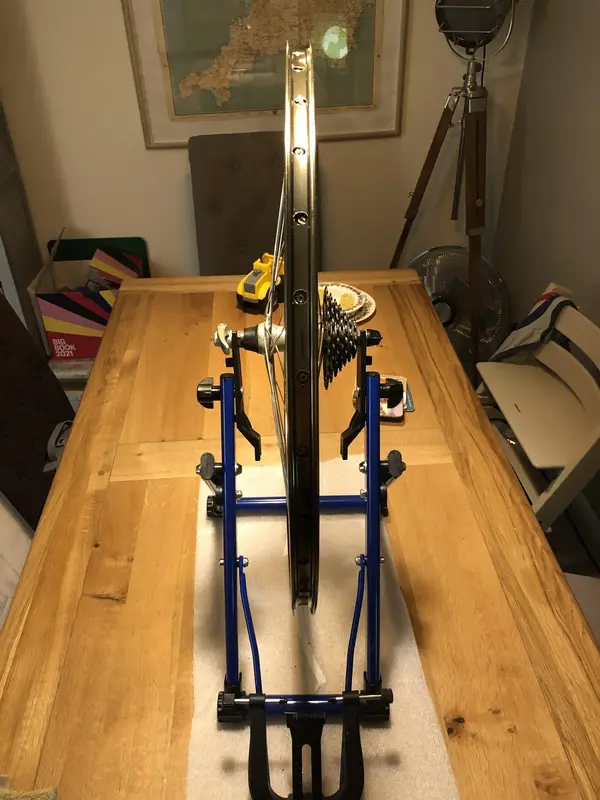

7) lastly, true it up Straight inline with that bit of tape you placed as to where the old wheel should be dish/aligned to.
Finished

So took me just over 3hrs (6min a spoke on average) to do and was a lot more effort than expected given the fine spoke length tolerances. But delighted with the outcome.
was it worth it to save £30, no 🤣 but it might be worth it once ive done a couple more. And i can now say I’ve built my own wheel up, sort of !
the almost finished wheel, just another lap of nipple tightening a bit more dishing over to do.
