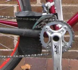

If you really want to extend the life of your drivetrain, you should have some kind of mudguard to protect your drivetrain. I made this chainguard out of a sheet of polypropylene and it works fine, aside from limiting fat tyres. I have found that I apply lube about 1/3 less frequently with this set up (I don't ride much in rain) and extended my drivetrain overhaul interval by about 50%.
