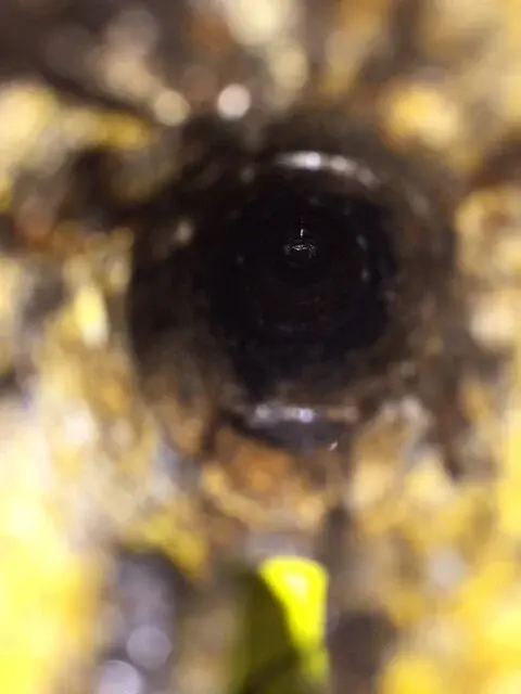

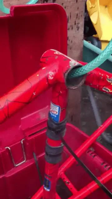

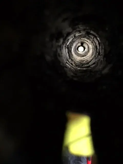

I did it few weeks back to a Karakoram frame,the post was stuck down inside the frame as previous owner had trying sawing and holding it in a vice.
Frame was turned up side down and placed in a plastic storage box.
The bb was removed and a funnel and fuel line hose was used to put the caustic down through the bb into the seat tube,the seat tube was sealed off using and old inner tube cut and slide over the opening then folded over n over a few times then cable tie to hold shut,the bottle bolts were removed and again inner wrapped round to seal.
When the caustic was put in and the reaction started I ran cold water down the out side of the frame to limit the heat transfer effects on the paint surface.
£10 of caustic from local hardware store was used and It took Near 2 hrs for it to be clear.
