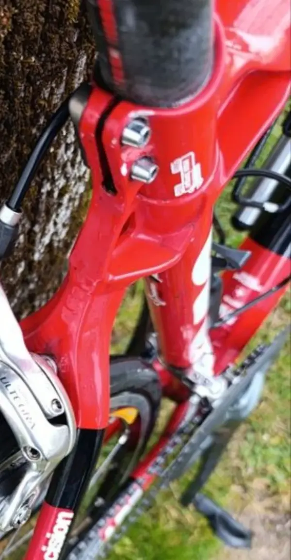

I have one of these very elegant BMC frames with the big aluminium lugs. Unfortunately the seat post system is a disaster, two bolts on a relatively thin aluminium structure, obviously eventually it's cracked!
It will hold a seat post, but it'll slip after a few days. I'm looking for a method to permanently secure a post into this frame, at my desired height, forevermore! I don't really want to go down the route of bonding a carbon post into the frame, if I have to I will though.
Is there another method to ensure the post stays put, and can be eventually retrieved (mechanically, or with heat, or penetrating fluid etc etc). I want to use this bike as an early season mileater, one which I can ride in rough weather and not bother too much about cleaning! It is quite a ridiculous design, thanks Swiss engineering...

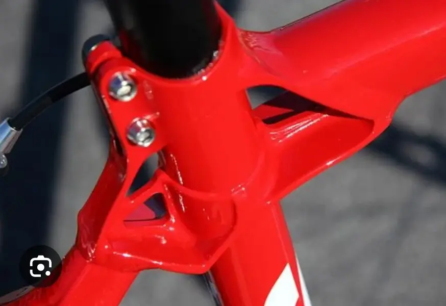

I'd be inclined to try a Vitus-style grub screw setup, maybe by bonding an internally threaded sleeve into the stress-relief section of the seat lug.
Someone suggested a coke can sleeve, but I guess I'd be concerned it would bond permanently with the aluminium lug.
I've thought about perhaps drilling a very fine hole in the opposite side of the lug and fashioning a metal wire binder, or a machining a very thin jubilee clip to fit. I'm not sure how much extra torque it will take to hold the seat post in place but I'm guessing it won't be much?
This is the side on view of the complete l seat ug assembly.
Anti Seize Compound is your friend, if you wanted to use a shim. Otherwise, skip the shim and use Loctite 638 + activator to glue it in for good?
I've seen the Loctite 638 used on bottom brackets so I guess it would be sufficient to hold a seat post in place. I'm not sure how much holding force the two bolts give with the cracked lug, but I don't reckon it will be much.
