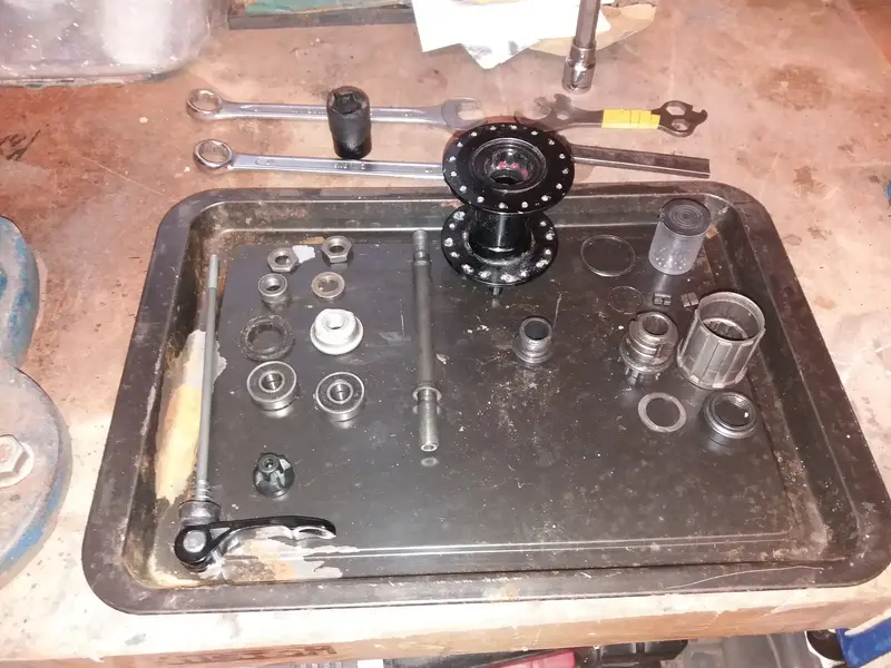

Oil isnt getting to those bearings without at least dismantling the axle and removing the freehub. Any that does get in will be so contaminated with grit and general crap as to be as good as grinding paste.
Take the axle out and split the freehub body. Pull the seal out the back side,you can grease the rear bearings from there. You wont get to the central bearings but neither should the parrifin have.
