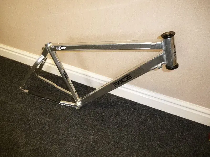

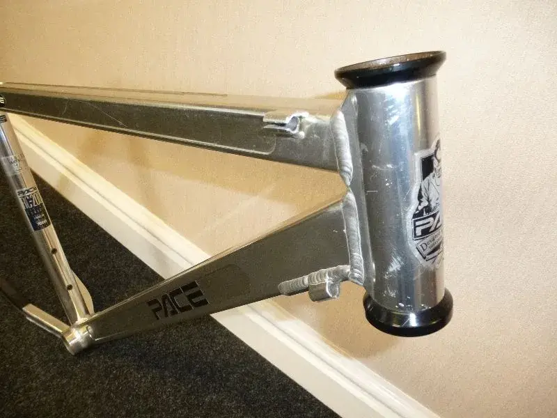

start of the project after strip down, metal polish at the ready!! :D

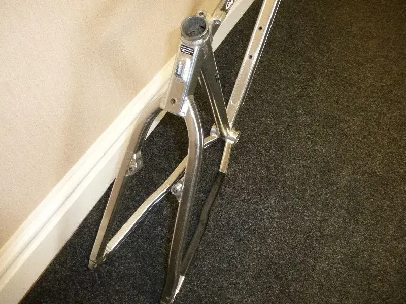

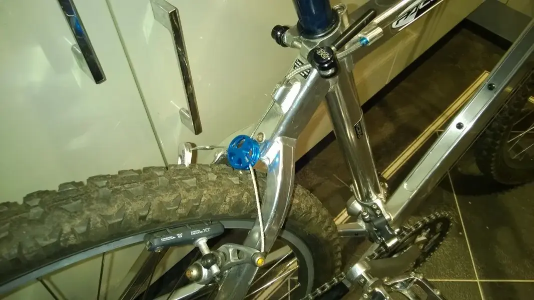

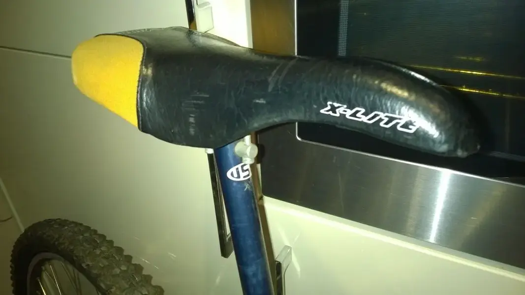

Not had a pace before, wondering how do you clamp the seat post on it? :? Don't look like got enough of seat tube there to be able to clamp it :?
orritt1974":3ny3gobo said:
it has a bolt on clamp that I have removed. I just took everything I could off to start a thorough clean up!!
Oh I see cool 8) look forward to build.

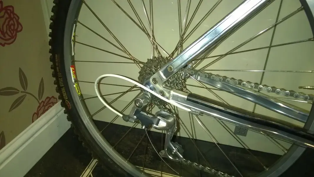

orritt1974":cdnvfzao said:
Hi to all! I'm new on here but was looking for some help!
I have decided to re-build my Pace RC200 to it's original state when I rode it in the 90's. I have got out of storage(my garage) the Spin carbon wheels I had on it. At this point I then remembered why I took them off! The rear wheel no freehub body and looks as though its broke around the edges? have a look at the pictures I've attached. Can anyone tell me if this can be fixed? is it just missing parts? if so, has anyone got any spares or can I just get shimano parts etc? Someone please help!!
Believe the original hubs were built and supplied to SPiN by Hadley. Have experienced this before myself and used the guts/freehub body from an hold Hadley hub to fix it and it's still going strong today.
