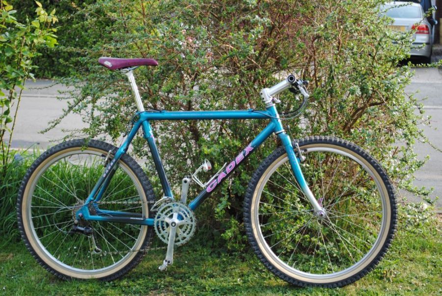

this fat lump weighs 24.9 lbs with no nod to weight saving:
I've not really tried to save wegt specifically, just missed fitting extra chainrings, front mech and shifter, as well as using xtr, which I assume is light.
Nice bike btw, like the colours on that one. I'm toying wit using the original rigid fork at some point, as I managed to source one which turned out Tobermory the right colour by a fluke of some magnitude as the frame was bought in the uk, the forks from holland I think, or even the Czech republic.
