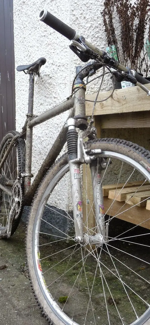

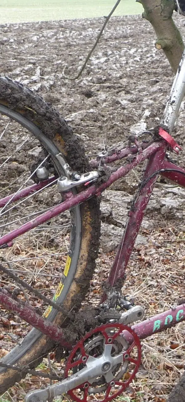

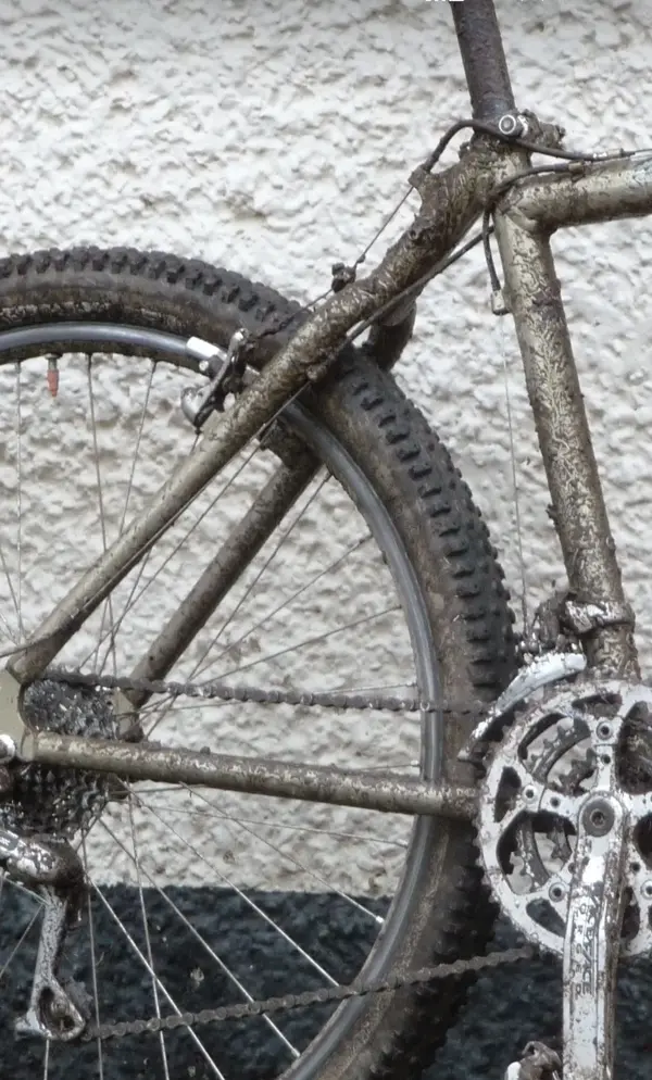

Screenshot_20240225_130410.jpg Screenshot_20240225_130316_com.google.android.apps.photos.jpg Screenshot_20240225_130050_com.google.android.apps.photos.jpg
