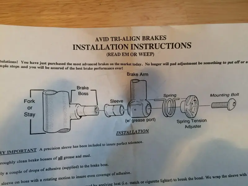

The brakes I'm trying to fit are Avid SDs. Unless I'm missing something really obvious, I cannot see how the spring can be adjusted.

TriAligns are direct fix to the stay stubs. The bolt provides rigidity. And the spring can be tightened or loosened just by using a spanner. When I removed those old Avids, I found myself with neither boss, nor any methos od tensioning the reaplcement brakes.

Are you sure that you dont have 4 sleeves? The 2 that belong to the Avids (see pic (hopefully)) and the 2 that are from the frame as shown above and also see here
One may be stuck inside of the other.

That's the point I was trying to make. There must have been a boss/sleeve or something on there if the brakes came off the frame. They don't pivot on thin air.
