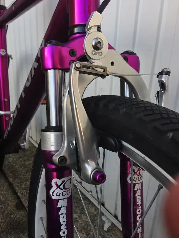

Had similar problem on the wife's muddy fox, kept canti levers and added this gizmo onto the V-brakes on suspension forks, the eccentric roller basically means you can operate v-brakes effectively from a canti lever, thus keeping the cantis on the rear and retaining canti lever/shifter combos.

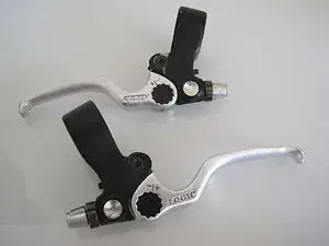

There were some Ritchey Logic levers that could be switched between canti/V brake settings

you have the wrong one jussa its the one above that lets v's work on canti levers.
Yes pies, it is the correct one, it's a Problem Solver for using V-Brakes with Canti Levers, said so on the packet, and I've got Cantis fitted to rear and V's on the front. With Canti Levers/Shifter combos on the bars.

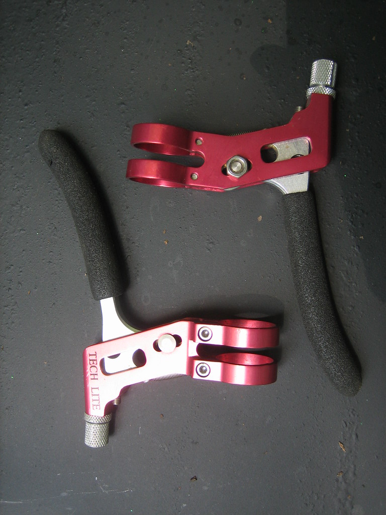

Avid make some brake levers that work with either, I think.
SD-7s or something like that. I bought a couple of pairs, NOS, from an eBay seller a couple of months back, so there's probably some kicking around still.
