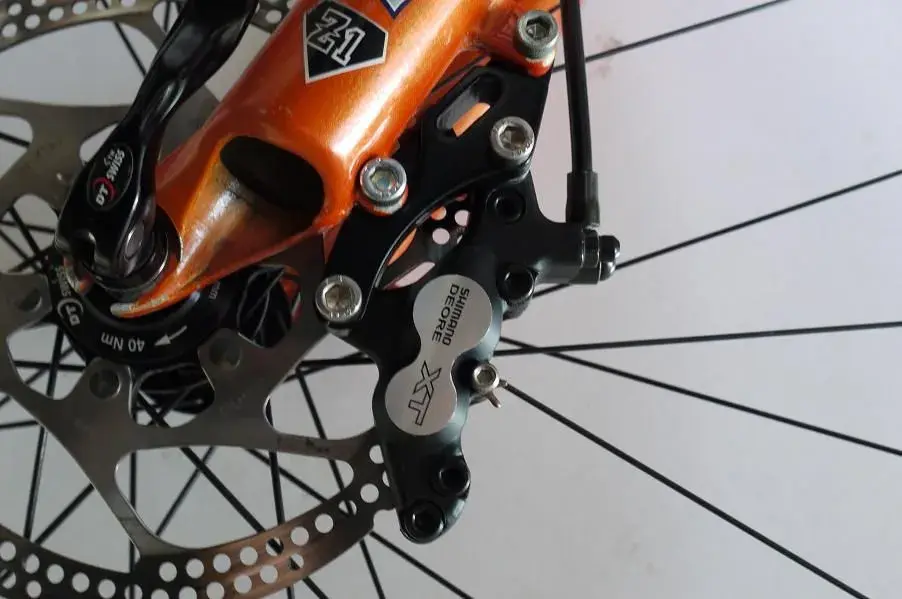

It's always satisfying to see your work on other peoples bikes, great pictures guys, I'll add them to my scrap book :D

Nice work B3 8)
Wow B3, you have made a nice job of those adapters. :D

I have only just found out the my Z1 Bombers (1996 and still going strong) do not have the current ISO standard caliper hangers and so from what i have found i need to get an adapter made.
I know that you do not have any adapters left however can you advise if you have a drawing of the final design? If you do not have a drawing I will try and come up with my own design (based on the pictures of yours).
For anyone else out there who still has Bombers and want to fit disks, I will keep posting with updates of how I am doing with this project. If it looks like i have a workable design that i can produce at a reasonable price I will take orders prior to a production run.
