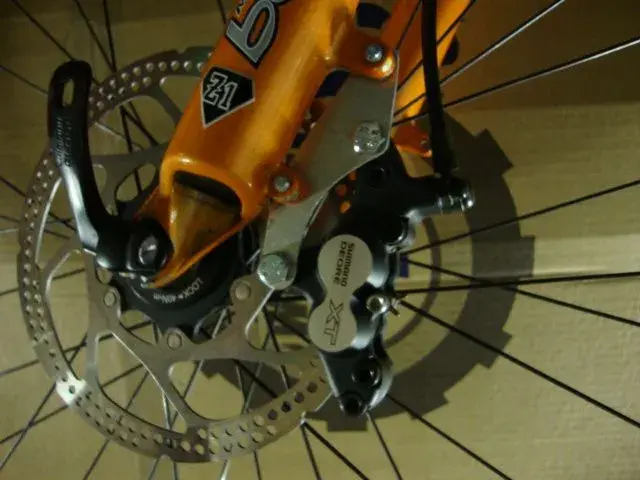

I have Z1 Bomber, 1996 vintage. I am working with B2 (member on this forum) to get some adapters made up to convert to IS mount.
We are at the last stages, I'll be making hopefully the final template to check all fits then B1 will bang out a few ..... :lol:

It's true, I should have some adaptors to mount IS standard calipers to Z1 & Z2's in the next couple of weeks.
You can redrill the upper hole closer to the fork leg to get the 51mm spacing, but you will then need to use a 177mm disc.
I love this forum! 8)
Have money, will pay... ;)
Fantastic. You know where to find me! :)
I think I'll just wait for your adapter... ;)
