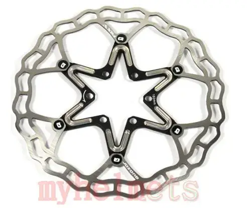

.... money spending is continuing - since I last posted, managed to get a set of Formula R1s so that is 50g off the weight.
..... but they are gold coloured so spent even more money on getting black calliker caps and black alloy bolts
.... and you say it is never ending since the Hope Saw rotors do not work with the callipers so will be needing new discs ..... but then that will be the end.
ordred one of these - will see how it works out, and then will get another so hopefully will be done.

How did you get on with those new rotors ? I was going to get some Hope floating ones to replace my Avid G3's but these may be better.

I have used KCNC razor - more air than braking surface and am not happy with their stopping performace - these ones look like they should do better (I did have lightweight variant of Hope SAW but they interfere with Formula R1 callipers).
Avid G3 are pretty good for the weight/price, Promax rotors are about the same but maybe 10g lighter and slightly cheaper.
