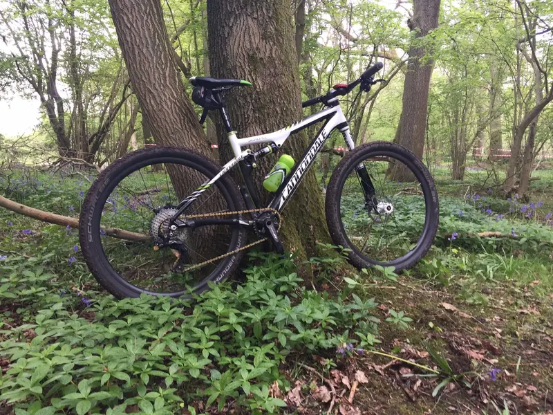

I absolutely love these bikes and had one which I raced for many years, I did a 27.5 conversion on mine and was probably the lightest 27.5 bike around at the time! I have a lefty sat in the shed for one of these but it needs a rebuild

Mine had the lefty to start off with which obviously doesn’t have clearance issues, I then built custom wheels using light bicycle carbon rims on dt240 and a lefty hub, and i also fitted offset bushings to lower the bb and slacken the head angle! If you ever want to do a 27.5 conversion it’s well worth it, mine was an absolute weapon in the single track I miss it so much 😞 this is about the best picture I have
