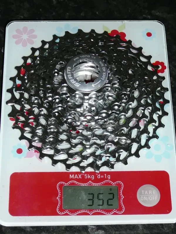

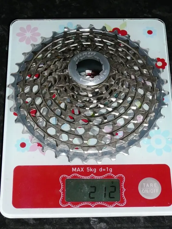

Fitted the X0 / XX kit to the bike today so now waiting (getting used to this ... :roll: ) for a 10 speed KMC-X10SL chain from Taiwan but in the meantime have to say how awesome the XX cassette is as a piece of engineering. I did buy a PG1070 cassette before new and thought thats a big lump of metal but the XX in exactly the same ratios is like a feather in comparison. They claim it takes 9 hours to CNC machine each one and I can believe it - spot the difference ? :shock:

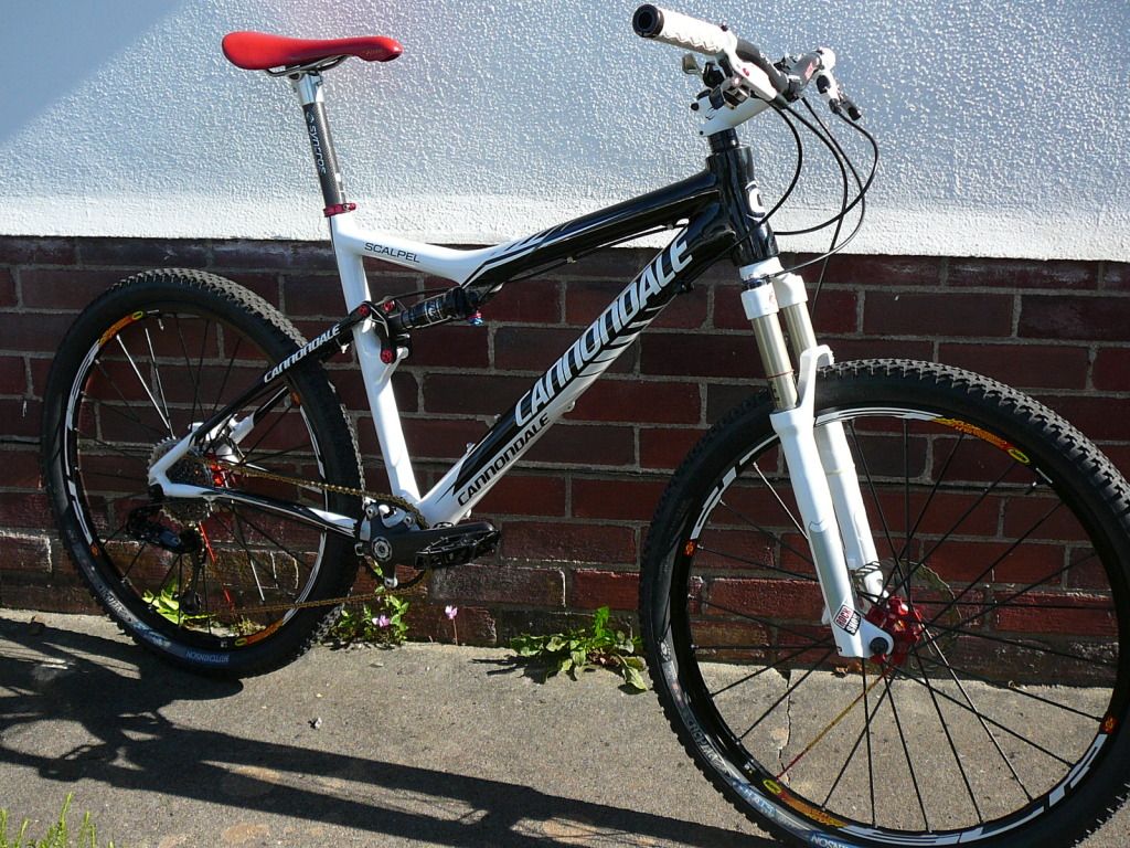

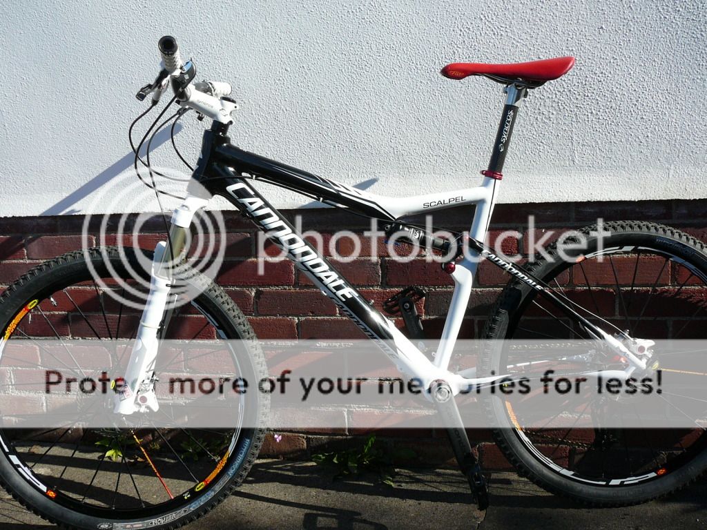

Finally finished the Scalpel ! (for now ... ) :D :D :D
Really pleased how this has finished up and have learnt a lot on the way thanks to Cannondale and their odditties. Here's the spec ...
Cannondale Scalpel 2011 frameset with Fox RP23 shock - 80mm rear travel - and Cane Creek Si reducer headset
Rockshox SID Race forks with Pushloc
Mavic Crossmax SLR wheels and Ti skewers, Hutchinson Python Light UST tyres
Cannondale Si Carbon BB30 road chainset with Si ceramic bearings, SRAM 10 speed 34T chainring
SRAM X0 1 x 10 mech and shifter plus XX 11-36T cassette and KMC X10-SL chain
Avid Ultimate disk brakeset with 160/140 G3CS rotors
Syncros carbon Gain riser bars, Syncros FL 90mm stem, Syncros carbon 31.6 seatpost
Wellgo MG1 magnesium flat pedals
and finally for the Retrobikers ... Red Flite titanium saddle (1997)
Bike weight 21.2 lb
I've not tried it out properly yet but it feels very quick and you don't notice the suspension working - keep having to look at the shock - but very very smooth.
All in its come in under budget and under target weight even with fairly fat UST tyres and flat pedals so very happy with the end result.

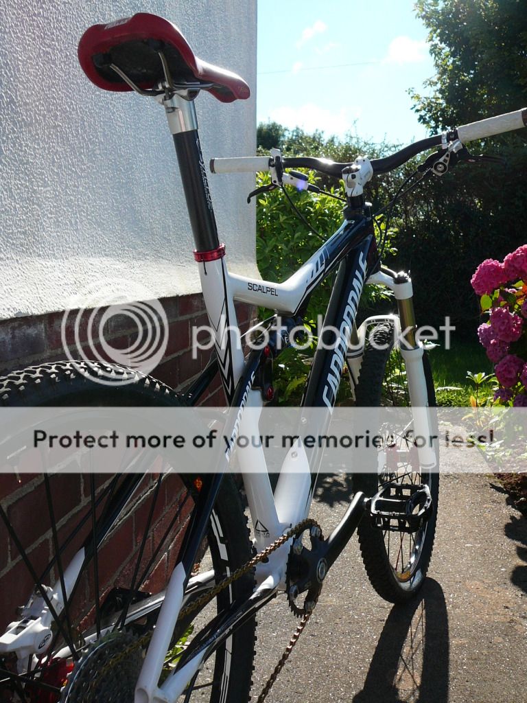

Here's a few more piccies.
Super light XC bikes aren't usually my thing, but this is lovely (probably helps that I have a thing for Cannondales). Bet it absolutely flies.
Are you planning to fit a chain device or see how it goes?
Rumble":35z8kljv said:
Looks stunning, but aren't you going to lose your chain a lot?
I was wondering about this.
Never tried the 1 x 10 setup so will have to see if I need a chain device and also whether one will actually fit - most are for external BB aren't they ? It's a 10 speed non ramped chainring but when at the top or bottom of the range the chain is at quite an angle.
Not sure about the need for a long cage mech either tbh , SRAM recommend one for use with the large range cassette but I guess thats with a 2 or 3 x 10 up front. Would a short cage be better to keep tension ?

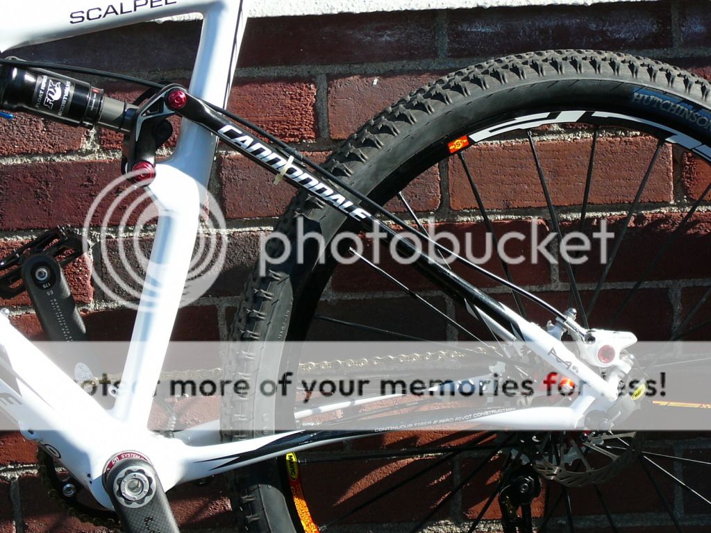

doesn't your frame have brake hose mounts on the chain stay? not seen one with rear hose routed like yours.
Hi, good choice on the Scalpel it really is unlike any other bike.
I'd love to go for weight loss on mine and get under the magic 20lb mark but that would take serious £££ so keen to see how you get on with yours. A Lefty would save a good bit of weight but they're not for me and changing wheels etc is too much at the moment. Mine's changed a little since the pics - now got an X0 BB30 2x10 chainset and XX shifters as I found I needed the granny ring and my bum was no longer Flite compatable and been replaced with a Ti railed Spoon type so think it's probably more like 10kg now.
You're right I do have chainstay hose guides but the brakes I bought didn't have a long enough rear hose to go that way hence the alternative route - I'll do it properly when the brakes get serviced ! :oops:
