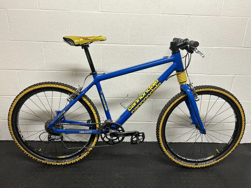

I've recently picked up a 1997 Cannondale F2000...finally scratching an itch for the last 30 years. It's a really tidy frame and even has an unworn snazzy Coda 701 CNC chainset.
So, the headshok appears totally solid. Is this user-diagnosable (I know often serviceable only with specific tools) or should I simply ditch the whole thing and fit a normal fork with a reducer headset. Are spares even available?
I'd love to hear thoughts on what to do next...

Honestly I don't know yet! I will look under the crown for a valve. The F2000 it should have a Fatty 70 which is air / oil.
I’ve got a F3000SL which I bought a few years back. It had a ‘seized’ fatty SL and the whole bike was silly cheap because of it.
Anyway all I did was let out the air completely , push down hard to release them and then inflate again. It’s been perfect for 3 years since. IMG_2793.webp
Thanks for that. It looks like it has sat unused most of its life, rather than neglected or worn out, so that is going to be well worth a try. Very helpful!
