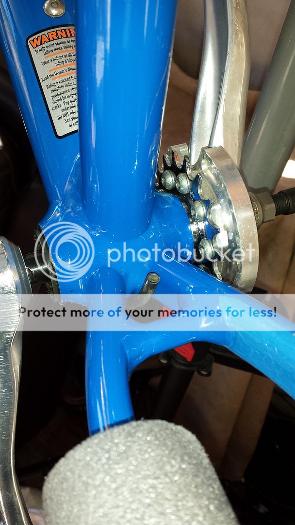

I bought a Cannondale Ashton Signature frame last year (I think it's identical to a late model Beast of the East) which came with a bottom bracket installed.
It seemed smooth with no play in the axle and isn't seized (I don't have a tool but the guy at my lbs had a quick check). The problem is that on the non drive side there's lots and lots of clearance between the crank and frame but on the drive side, the chain ring was pressing against the bb cup before I could properly tighten it.

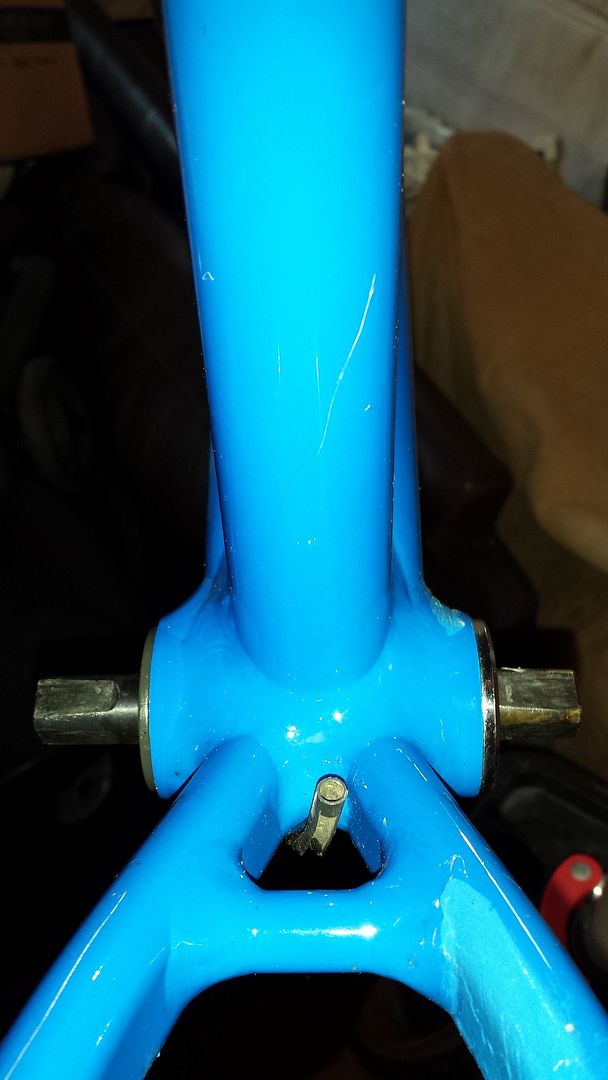

The axle definitely protrudes much more on the non drive side:
My first thought was, is it in the wrong way around? But the lockring is the non drive side, which I thought was normal.
The axle measures 110mm so if I do need a replacement, what size should I get (looking on CRC, there's more options that I'd thought). I'm also assuming it'll be a 68mm, English thread, is this right?
