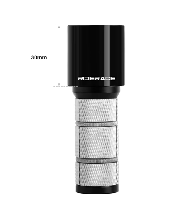

OK kayos what size steerer will these fit or have got them for all I got some manitou steerer that are to short w how does it work do you use a long bolt that goes through your adapter and into the spider nut thing (can't think of name) that in the forks locking it all up cheers also how long are they
