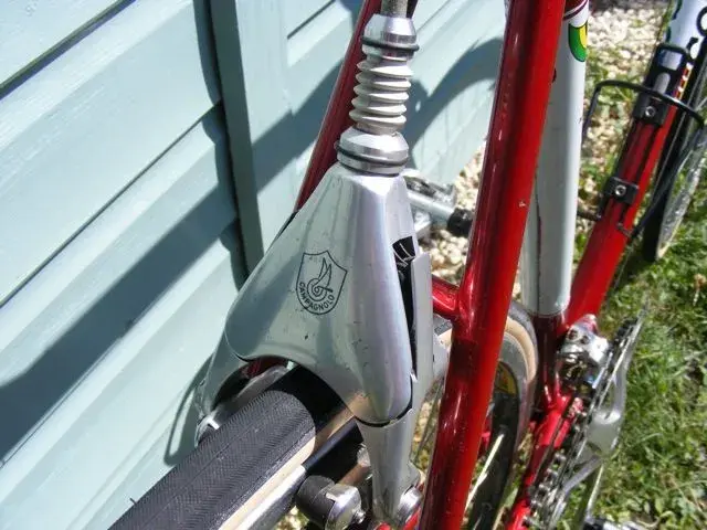

B bikenut2010 Senior Retro Guru Aug 5, 2011 #1 any gurus out there for set up? mine go squeal , hand aches , squeal , hand aches ,squeal , hand aches , squeeeeeeeeaaaaaal, shudder, hedge... :shock: Attachments DSCF0398.webp 43.5 KB · Views: 325
M mark34 rBotM Winner Aug 5, 2011 #2 use the small allen key bolts to give the brake pads some toe in. Also grease the axle, washers and 5mm allen bolt that goes through the brake bridge.
B bikenut2010 Senior Retro Guru Aug 5, 2011 #3 Deltas thanks I'm on it, toe'd the pads in already, think the rubber is old and hard and glazed surfaces tho'...will try the other tips now
