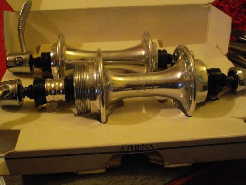

Well today i really pushed the boat out & brought these for my 2 Konas.

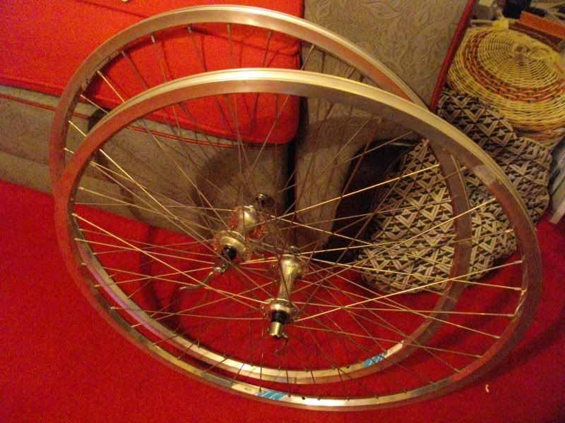

I got these hubs, another set of hubs the same laced to campag Atek rims & also a front mech.
Knowing very little & looking on the archive on here im starting to worry that they may not be mtb hubs. Can anyone tell me what ive brought as the only reference i can find t Athena is for a road bike :?
I will post a pic of the wheels in a mo ..... any help would be appreciated
yes if athena they are for the raod .
check the spacing if 130 or 135 mm , mtb if 126 road bike .

Thats what i was starting to think but hoped not :(
I was sold them as MTB so i will take them back.

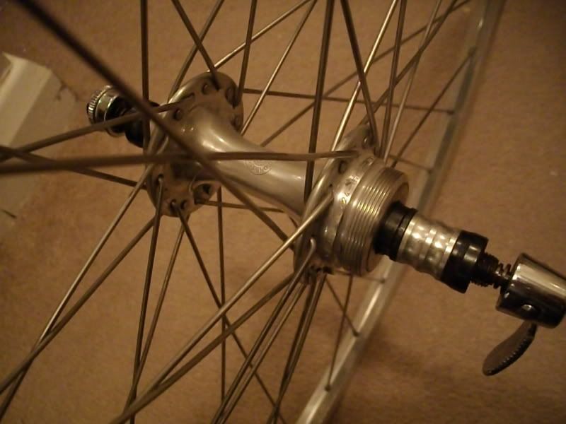

OK, this is stranger again ....... the rear hub on the built wheel fits the 130mm dropouts of my Kona perfectly but the rear hub in the box are shorter so i guess they must be 126 (road bike)
Both sets of hubs look the same but i guess the built wheels hub has got to be MTB if its 130 ?? ..... but i cant seem to find it in any Campy MTB catalogue.
Now i really am confused :? ...... anyone reconise it as mtb ?

126 and 130 were both available as road frames were available in both size for a couple of years.
Just like XT hubs were available as 130 and 135...
If your frame is for 130, I wouldn't worry about it as the road and MTB hubs of that generation were so similar anyway.
As for the 126 - you could fit a new axle and spacer.....

Cheers db,
i am happy with the wheels now, they fit my frame fine & spin forever.
I think i will just take the others back.
