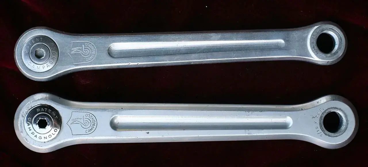

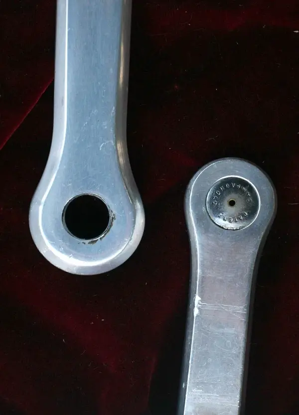

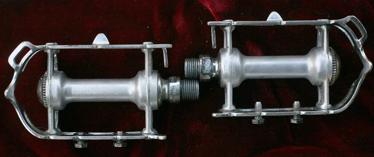

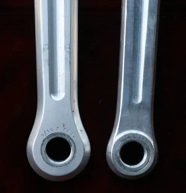

Not surprising that you can't see the difference because it is subtle, but a subtlety that makes a huge difference in collectibility. The easiest way to spot the first generation crank is the raised lip around the pedal hole; the next is the caps on the back of the pedal hole (except when they go missing) Next the arms are noticeably thinner and they lack the webbing at the center. Also the BCD is 151 not 144, an attribute that is shared with the second generation crank. The pedals have a shorter threaded area so to work with the cap mentioned above. The cage is less refined and the chroming is thinner and the pedal caps printed with "patent" and "Campagnolo" are thinner and toward the outside of the cap. This one you can spot in my picture since I have one of each, the pedal on the left has the Nuovo Record cap, the one on the right is original.

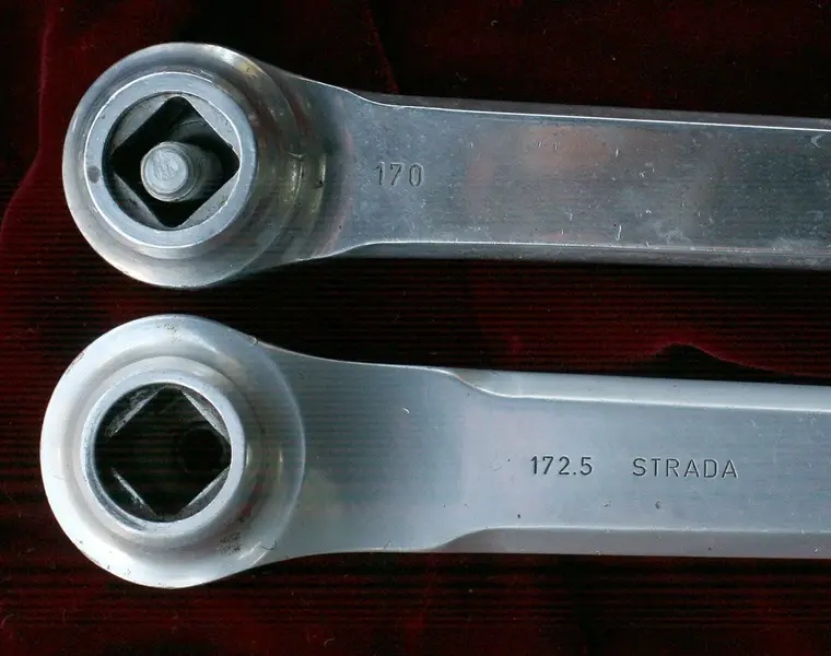

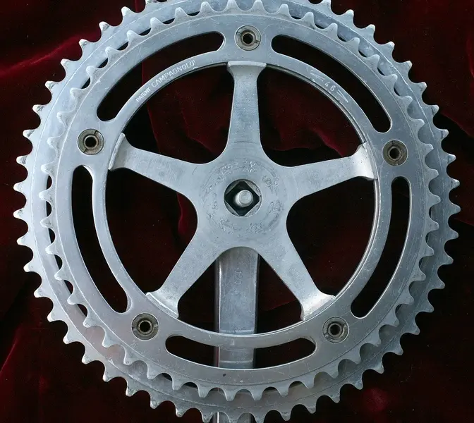

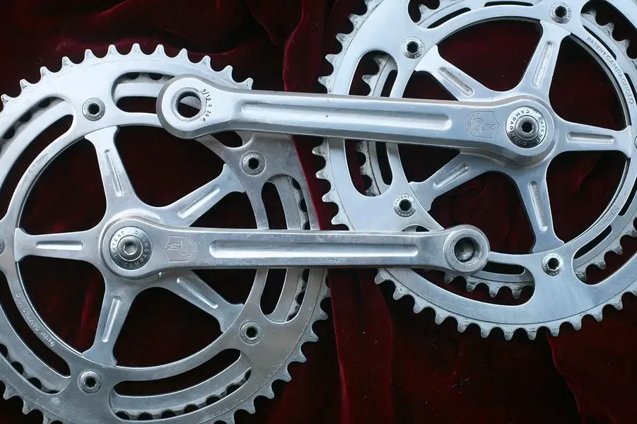

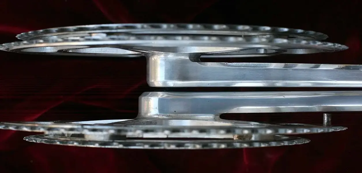

Following the question about the differences between the first generation crank and the later ones I put together a few side by side photos to visually document the differences.
The two cranksets are the 1958 Record and a pre 1973 Nuovo Record that I had lying about. One caveat the NR cranks are 172.5, whereas the Record are 170 which may exaggerate some differences.
I am going to do several updates so that I can illustrate more completely the differences

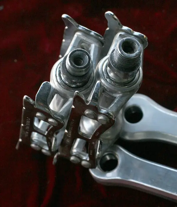

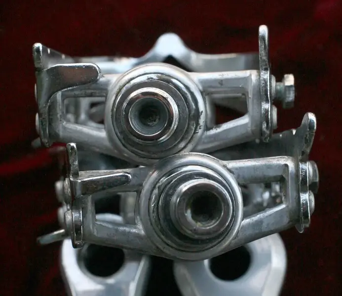

Next a comparison of the pedals, which have some differences aside from the threaded part of the spindle. As I noted the cage on the 1958 pedal has much thinner chrome and just looks less refined. Also the strap guide, not the loop the one on the inside of the cage, is much thicker.

I Guess the newer cranks have a 3 in a diamond stamped on them:) The outer ring also has a pin on it to stop the chain from sliding down the crank, I wonder when Campag started that?
Do the old pedals have a rifled part to stop water ingress?
Shaun
Just realized I did not photograph the ends of the pedals, will have to correct that.

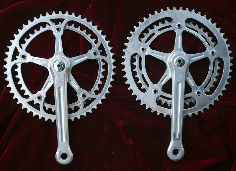

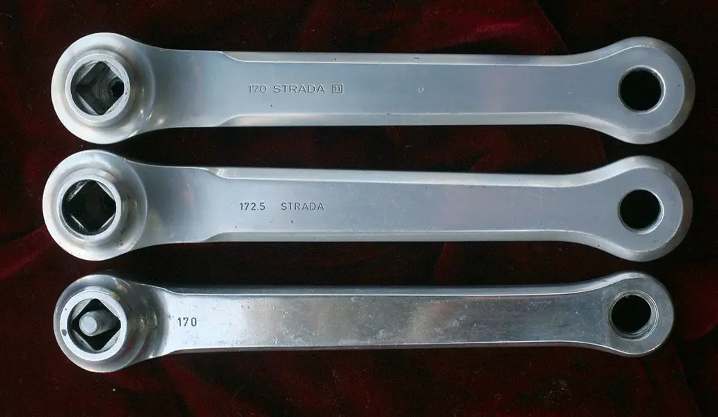

Next comparison adds a Super Record arm from 1986 to the line up. I found only very subtle differences between the NR and the SR th most obvious being the rings and the engraved date code.
The first generation crank lacks anodizing but the other two have an equal luster aside from wear.
Shaun
The pedal spindle is rifled. The NR crankset is from before they started with the date codes, so some where between 1967 and 1973
AFAIK Back in the 70's the Super Record cranks were the same as the NR cranks of the same period, just the rings were different. Rather like the only difference between SR and NR brakes were the alloy brake block holders of the SR (drilled levers aside).

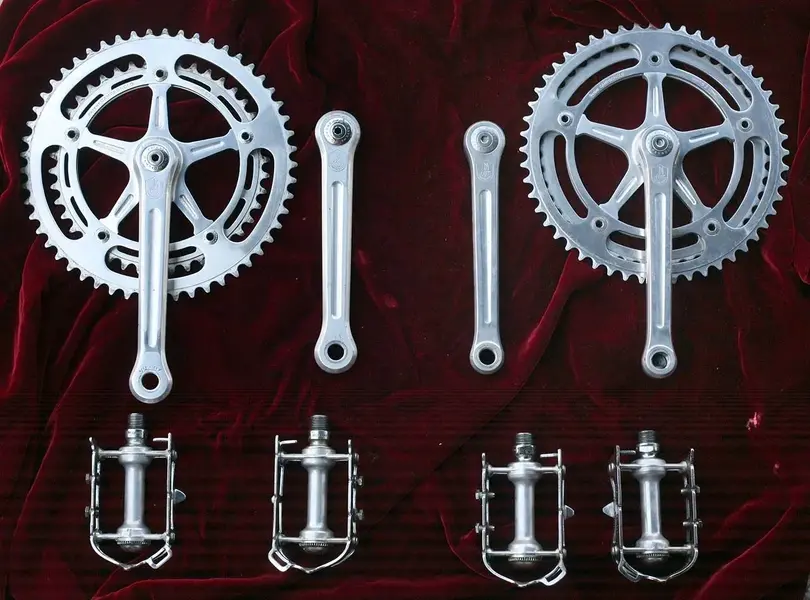

one more comparison showing all of the parts side by side
