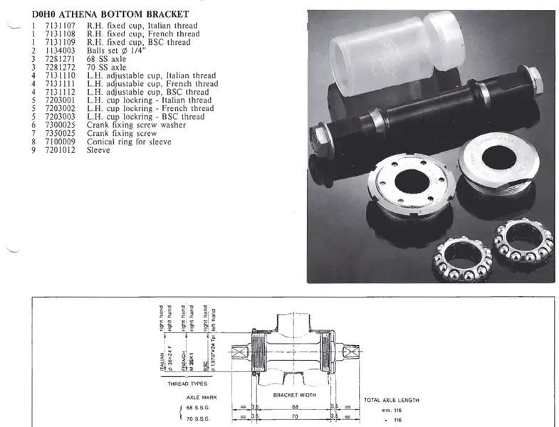

Just to confirm, is it asymmetric? The post 1978 axle was 114mm for a double add 2mm extra for Italian and that's about the length you have. Triples are a lot longer. Mind you with a 1990's frame that's way after my time lol
Shaun
I'll make some detailed measurements later, but that looks just like it.
It would also be about the right level within the Campag range for the model of frame.
