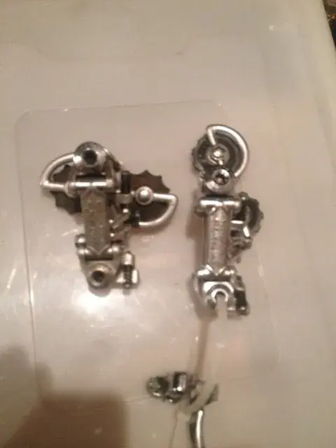

Sorting thru' parts, I have what appears to be a new quality RD but the jockey cage is rotated 90 deg from normal 'at rest' , is this an assembly issue? The spring seems ok...
Pictured on the right next to a normal one on the left.

There's a peg with a slot in the top, has the cage been tensioned and the screw put in. Item 812/1a in the diagram
Shaun
Undo the peg, from the front spin anti clockwise and put the peg back in. The cage should try and spin round but is stopped by the peg as it rests against the lower body of the mech.....
