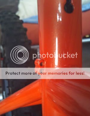

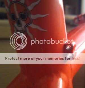

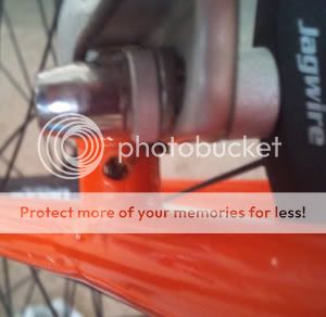

These are the holes in the frame the gear cable needs to pass though..
It will work for that.
Use shifter outer. it's easier to cut apart than brake outer. You can cut slit it with a utility knife in a pinch. Mind your fingers.
