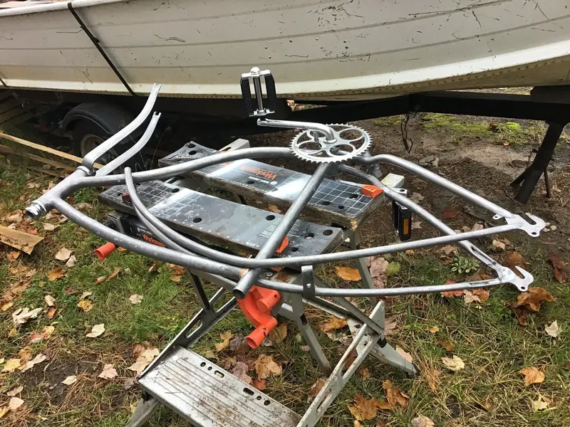

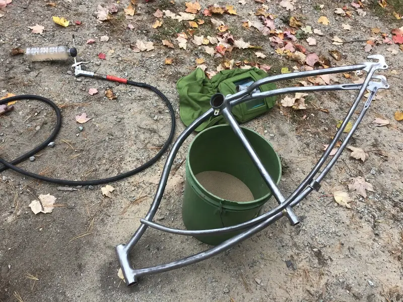

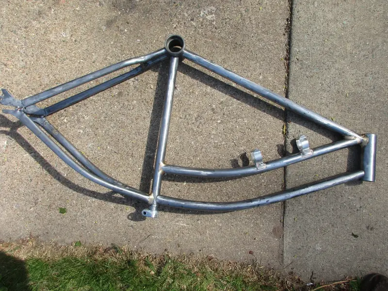

Wire brush in a 10,000 RPM angle grinder does wonders as the brush fans out to get in pretty tight. It’s real fast removing paint and rust. IMG_1167.png Then, where the brush won’t reach I use paint thinner and a small wire brush. Then dental picks. Then a homemade sand blaster to get all that remains. Where the cantilever meets the down tube and the rough welds where the drops are connected are impossible to clean out without a little sand blasting. IMG_0377.jpeg This will result in a perfect clean frame in about two hours. You might not have to use the sandblaster but you must completely get off all the little paint remover gum balls of old paint.

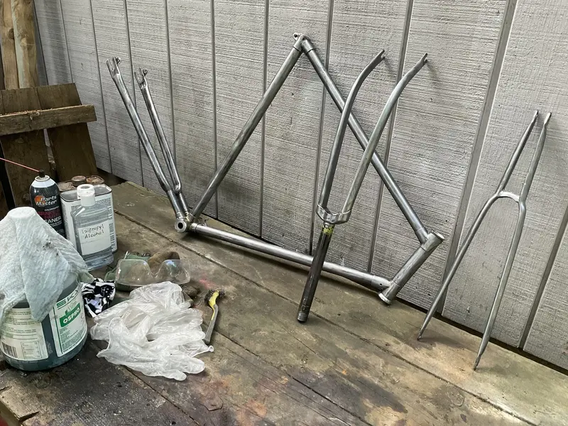

Wash very well with solvent. Then wipe down with Ospho, a powerful rust inhibitor. It contains phosphoric acid, will burn hands and eyes and eat concrete, so use gloves and eye protection. IMG_1168.png The next day you can prime. Make sure all the sand blast is out from the inside of the frame.
