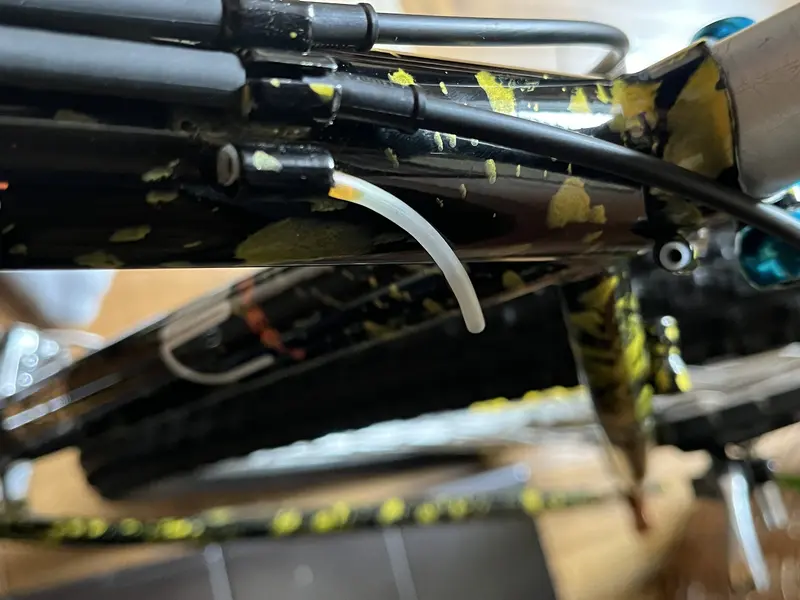

Get a whole roll like this: https://www.bike-discount.de/en/shimano-teflon-cable-liner-for-schift/brake-wires-1800mmFound some
I pinch mine out of V-Brake guides.They fit perfectly. Even have a lip on the end

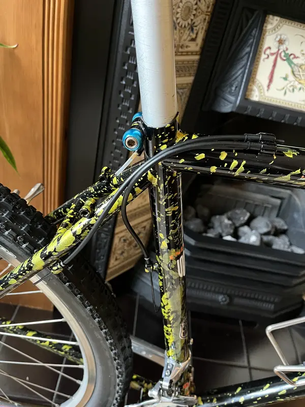

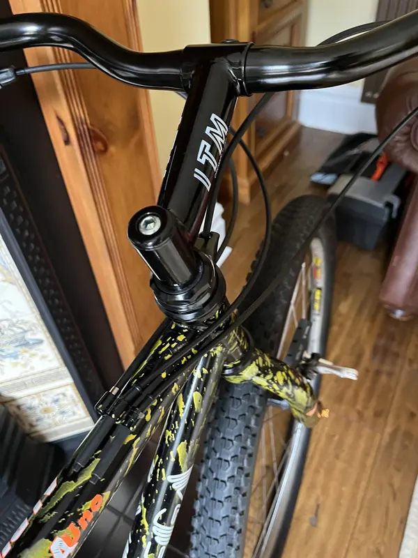

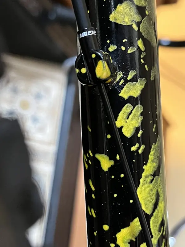

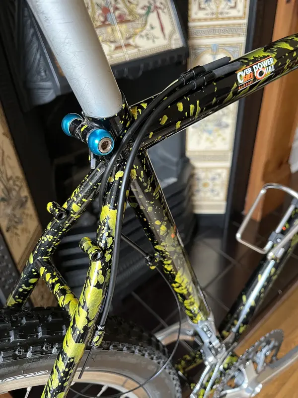

Like thisFront mech should be on drive side of seattube due to knobble placement and not getting in the QR arms way, plus all the catalogues show that, later versions would loop through the stays iirc etc.
Not sure on the specific year here (95ish?), but early 90s they had 2x right, 1xleft of head tube
Left to right it is brake, front, rear.
