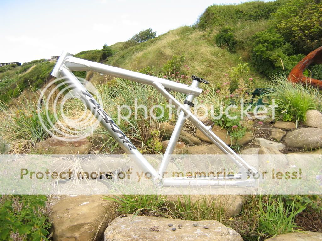

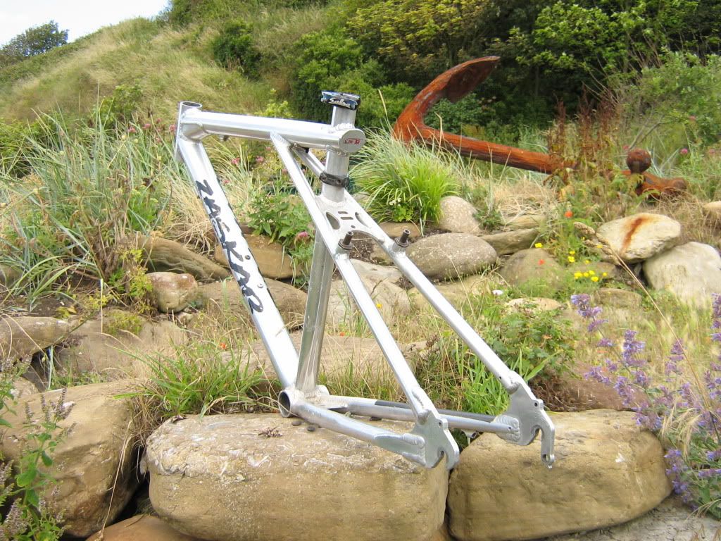

My next project :wink:
Just for you Mr Hendrix 8)
