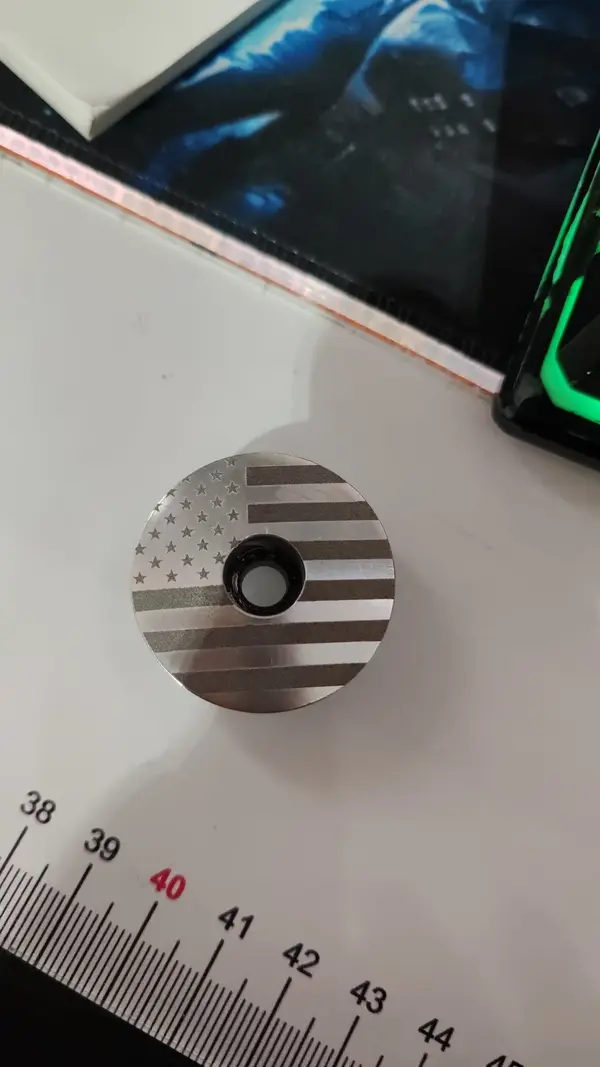

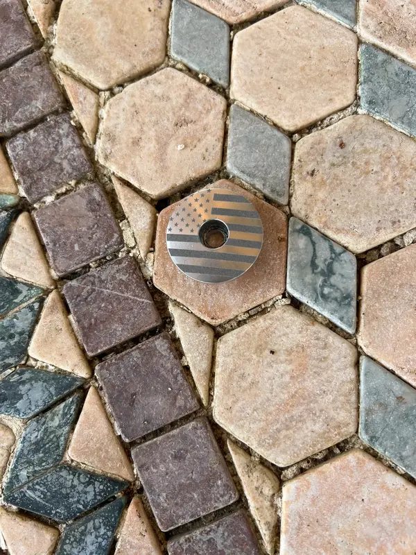

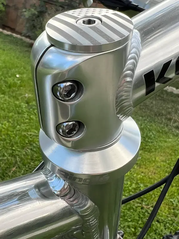

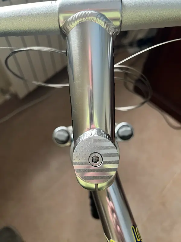

For now, I've tried doing it on the top of a Ringle headset for my Zaskar, which I gave a USA theme, and I'm honestly very satisfied.
The good thing about laser engraving is that it engraves on paint, metal, plastic... the bad thing is that if you make a mistake or it goes wrong, you've ruined the part.

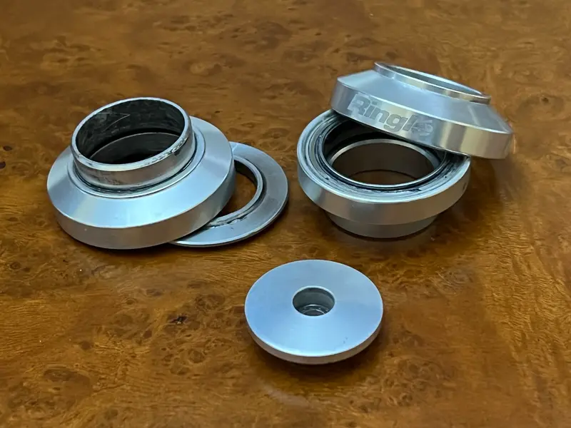

Good info i understood half of it haha but that ringle top cap looks good can you alter depth of the engraving also if i take a photo of say a ringle seat post to a sreen printer can they recreate it or do i need dimesion of the logos or would they take like a tecnical drawing (i cant do computers)are you in uk obi juan i been trying to find someone that does stick on stencils and stick on indivdual letters ie ringle as i going to be doing my own anodising so i want to mess about writing say ringle down a seatpost in a diffrent color to seat post like an xlite one
Before doing anything, I'd try it with one of those Kalloy models that we all have stored away in a drawer somewhere.
The seatpost is one of the most difficult parts to engrave because it's cylindrical, so I want to start with some cranks, which are flatter.
Well, actually, I already started with the Ringle headset cover, a simple and replaceable part in case the experiment doesn't work out.

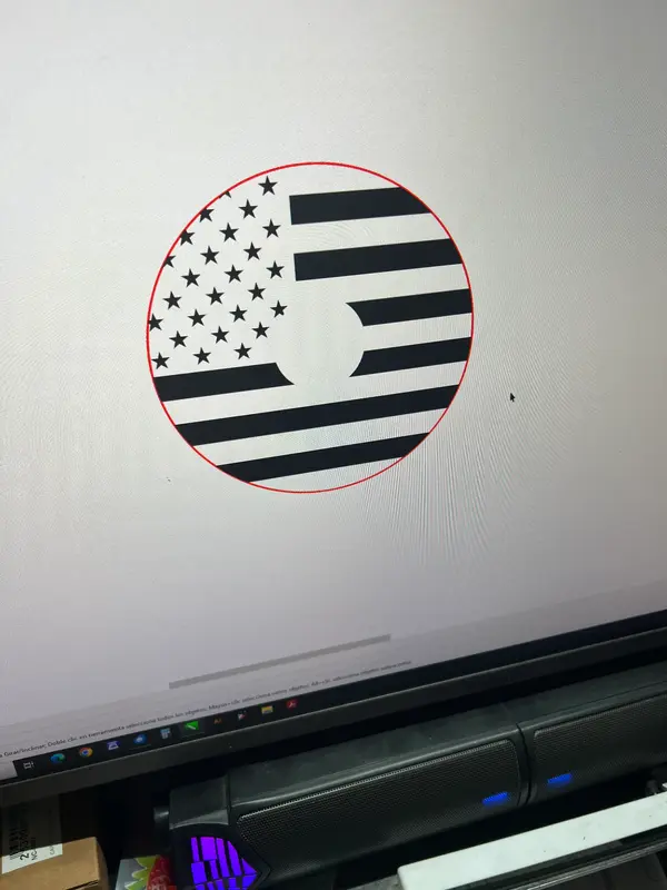

If you have a photo, it has to "draw" the logo and vectorize it to a format the machine works with (DXF, DWG, etc.). My advice is to first search online to see if you get lucky and the logo already exists in some print or cutting format.
For example, I searched "Ringle vector logo" and found this:
https://www.brandsoftheworld.com/logo/sun-ringle
It's probably not what you're looking for, but sometimes you just need to modify the file slightly. If you're looking for other brands like Specialized, Mavic, Klein, Ritchey... you'll be very satisfied with your search.
Next, you need to specify the size, which is usually the height x the aspect ratio (or vice versa, the length x the height ratio). You decide based on the space you have available or how closely you want it to resemble the actual logo.

The engraving depth can be adjusted, but it's trial and error. The best thing to do is bring an aluminum plate and test different intensities.
On the Ringle lid, I used a low-power fiber laser, and that was enough. But with other materials, you have to do tests before deciding which intensity is correct, so that it's well engraved and doesn't burn.
