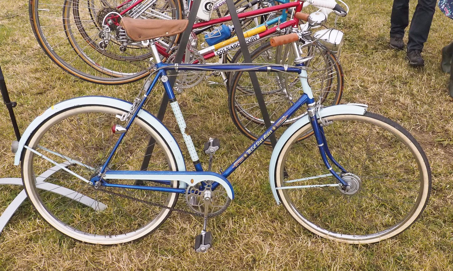

So I had a nice selection of tyres, now here's where I need help. This has happened to me before and I gave up, anyway the tyres on the BSA are 26" and yet none of my other 26" tyres fit the rim. See photos.
Notice how much bigger the BSA tyre is (BTW I am sitting down in that photo, it'd be a hell of a hernia if that was the gap between my legs :lol:
wCg-GTTaYLXRKtK_nWfOeMEkmyOFBsM_ToKsYZPkcsgpX92IB
u3Mf31lJwolUEcC-ZKw8Xy8PlJ_SOpFsU08NiAid7HgpX92IB
Has no chance of getting on the skinwall or these goodyear replicas. I don't know why on Earth this is the case.

Here's the bike now, I will probably put moustache semi drops on, not sure yet.
tBTCWSxUNG4r7HoylTR0X0t-a8xIO2uTy4lCtbJvAHYpX92IB
uNxYYcUrRHBcbQdRcoLRRb9aVkfCvz5lbRKh4-CzSSopX92IB

Thanks. So does that mean I can really only ever put 26 x 1 1/4 and 26 x 1 3/8 inches tyres on these rims?
Yes two distinct sizes not interchangable.
In the mid 1950s my tyre stock might have had perhaps 150 26 x 1 3/8. 100 26 x 1 1/4, 100 27 x 1 1/4, 2 28 x 1 1/2, 2 26 x 1 1/2 the last 2 obviously obselete, and a selection of tubulars.
If you have old British rims they will be marked with the size.
Keith
