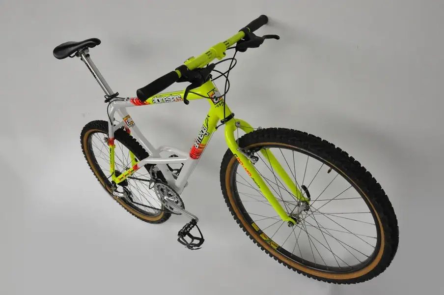

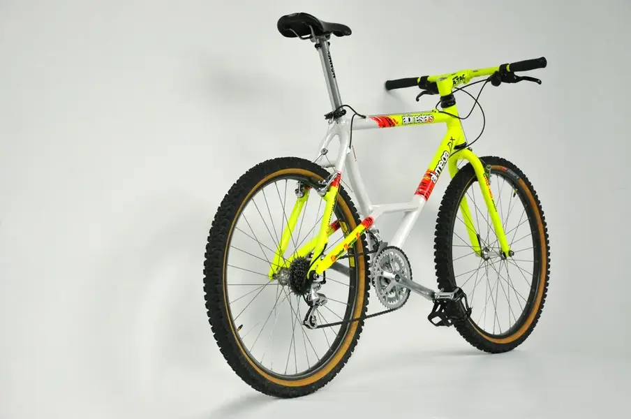

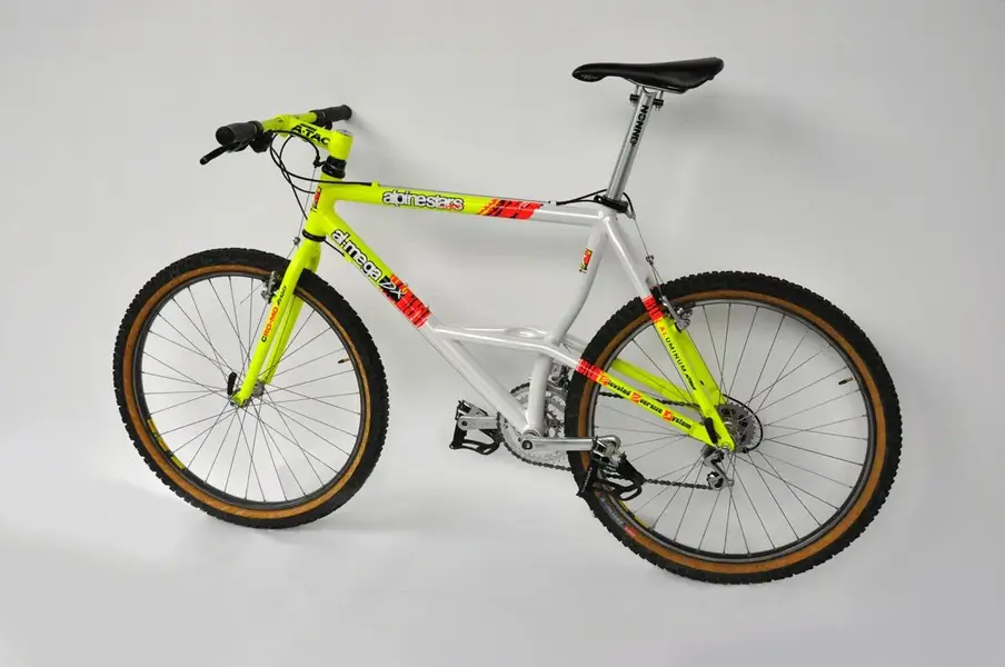

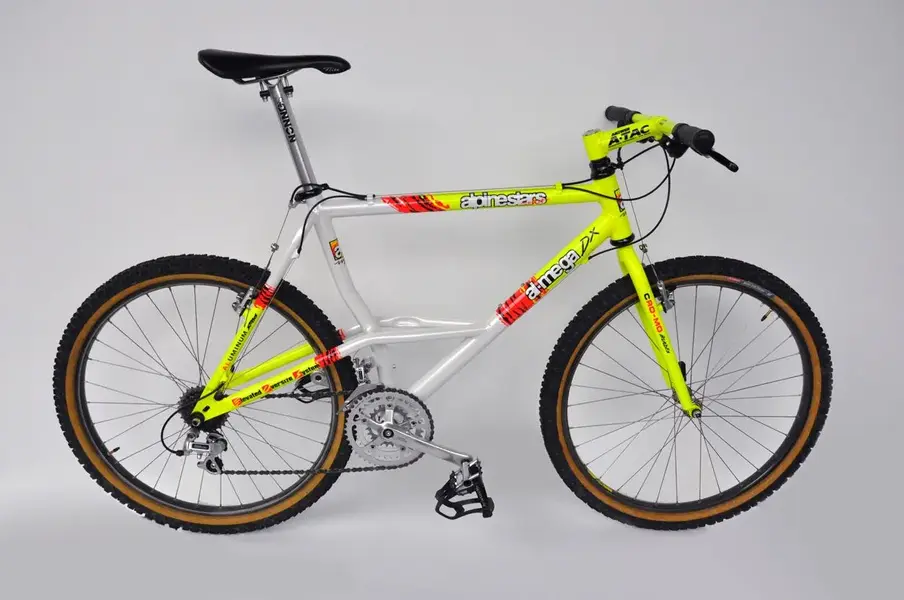

Cheers TC! 8) - apologies for the delay. Here goes-
Frame: 19" 1991 Alpinestars Al-Mega DX
Respray in pearlescent white ( Iosis X showcar colour!)
Neon yellow 'bands' ( Halfords can x3 )
Reproduction Graphics - neon pink/matt black overlay.
Clearcoated finish to seal.
Fork: Alpinestars 'CRO-MO' blades 1 1/4"
Respray in neon yellow as above. Reproduction graphics.
Headset: Black 1 1/4" 'no name' - parts bin special with Alpinestars cable hanger.
Stem: Answer ATAC 1 1/4" Neon yellow respray. reproduction graphics.
Handlebar: Answer Taperlite. Original neon yellow. *thanks to brocklanders023*
Grips: Ritchey rubber. NOS
Brakes: Deore DX cantilever F+R *thanks to Sinnett177*
Brake Pads: Black 'Aztec' New on front. Came with cantilevers.
Brake Cables: Wiggle
Cantilever cable hangers: Alpinestar OEM
Brake Levers: Deore XT SLR. Combined STI units
Shifters: Deore XT SLR. Combined STI units - ebay
Front Derailleur: Deore DX. Alpinestars mounting bolt. *thanks to RAFbikes for mech, Sinnett177 for bolt*
Rear Derailleur: Deore DX short cage. *thanks again to RAFbikes*
Derailleur Cables: Wiggle
Cassette: Shimano? - came with wheelset
Chain: Shimano HG70 - new from Wiggle
Chainset. Deore DX - ebay
Bottom Bracket: Shimano UN54 68mm x 118mm
Pedals: Shimano Deore XT 'flatcage'. NOS Mt. Christophe toeclips and black straps * thanks to Major22 for the pedals*
Hub Skewers: Deore XT 'rubber handle'
Rims: Mavic M261CD
Hubs: Deore DX
Spokes: DT Swiss
Tyres: Tioga 'Psycho2' amberwall - came with wheelset *thanks to Taffy*
Tubes: Bontrager 'presta'
Saddle: Selle Italia 'Flite' titanium *thanks to Mike S*
Seatpost: Shannon 31.6mm x 330mm. *thanks to thesneaker*
Seatpost Binder: Alpinestars
Cheers.
