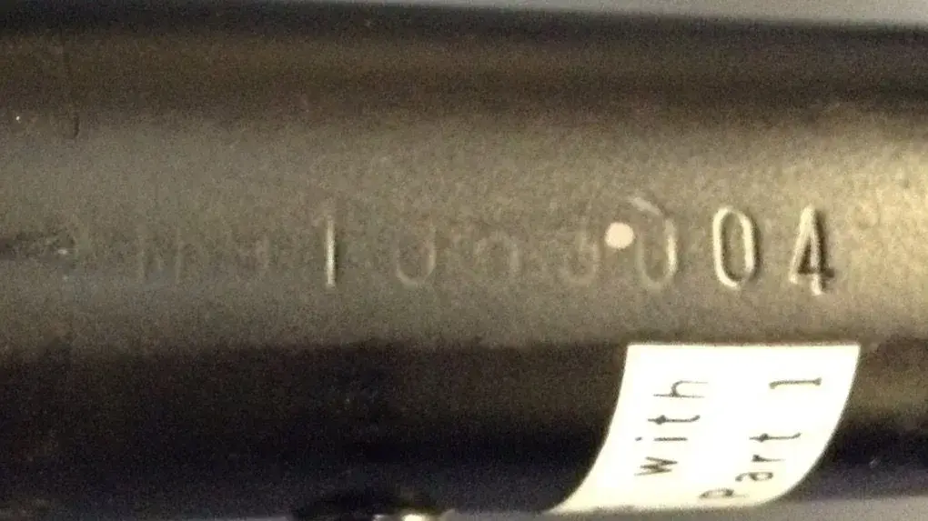

Strangley I never checked (I have know idea why I didn't as it's usually the first thing I check on any bike to make sure it's still there) However the new owner sent me a picture & it appears to be M 91 0000 04 I'm sure it'll pop up on here quite soon.

That serial number (maybe one of the 0's is a 6?) seems inline with the numbering of mine.
Are any Marin experts out there able to shed more light onto Marin's frame numbering system?
Maybe the M is for where it's manufactured rather than Marin?

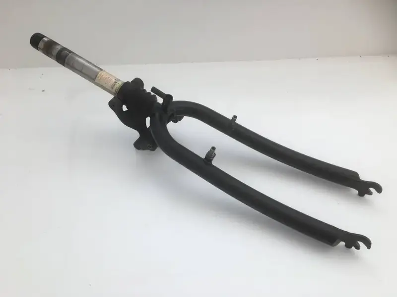

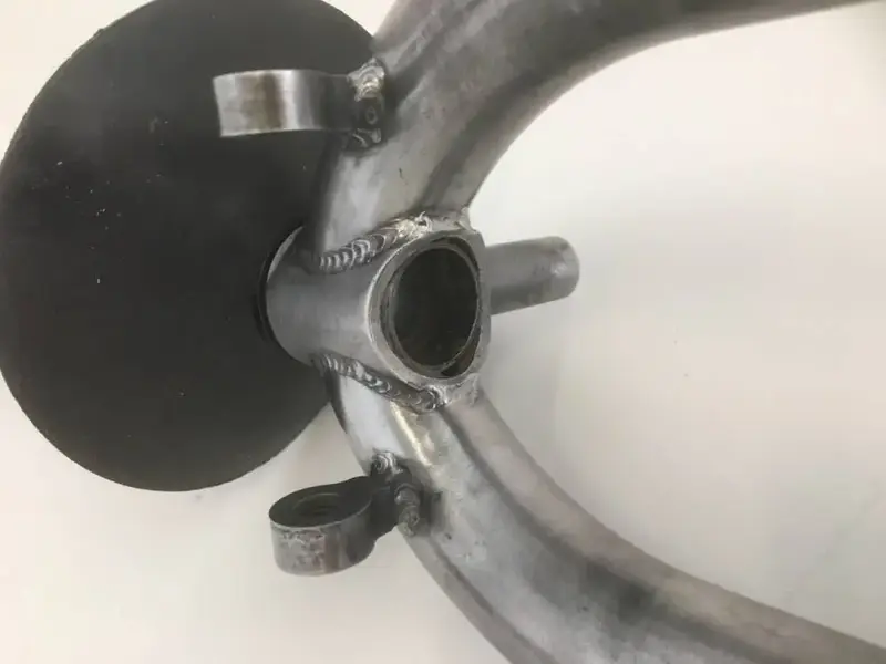

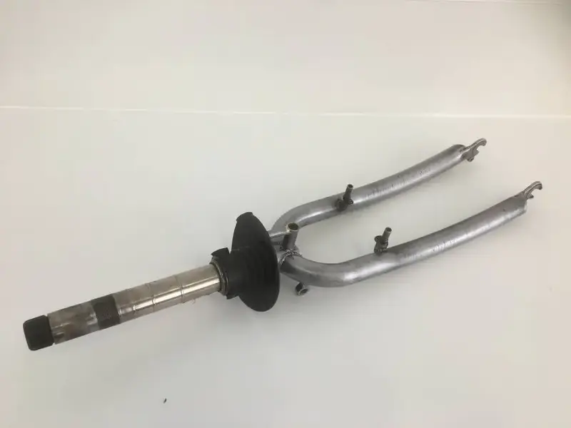

- Talking of Browning forks, I thought I'd make some progress on this restoration.
I began by dis-assembling the brace that stops the fork rotating on itself and cleaned it up. I then started to flat back the scratched black paint..... and realised that there wasn't much paint on these at all!! :shock: They had not even been primered! - so no wonder they were suffering from 'paint issues'!! As I'd already started, I stripped back all of the black paint to bare metal. The forks were sprayed and rubbed back using a high build primer before 3 final coats of Matt black. No lacquer added to replicate the original 'Smooth Zolatone' finish.
They were then reassembled. I've still got to do the 'noodle' part which holds the cable stop.
Now to get the frame stripped and paint underway!! - Neon Orange decals ordered too. :D
Here's some pics. The plastic cone around the rubber boot was to protect it from overspray, with a carrier bag wrapped over this.

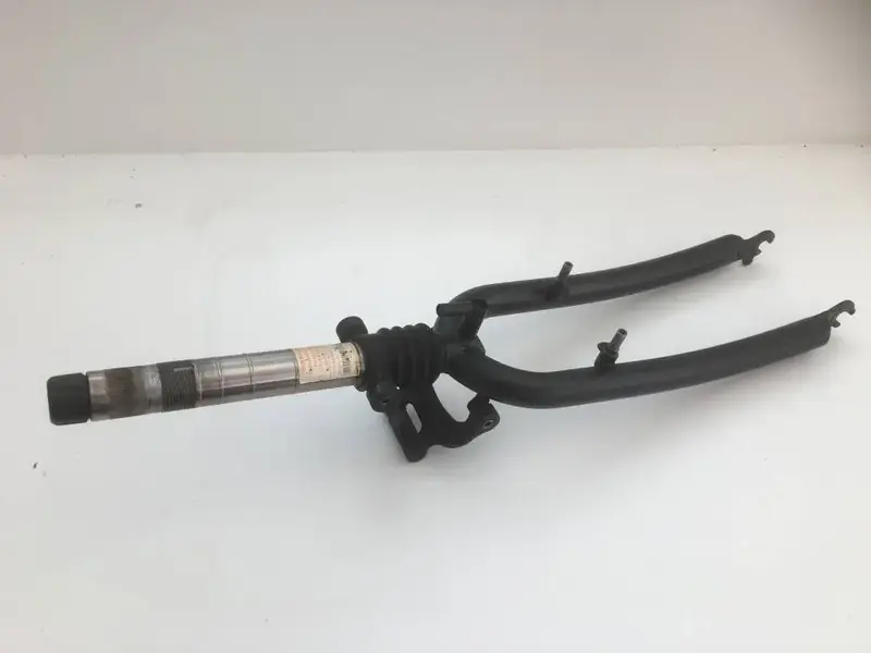

The painted fork..... onto the frame next.

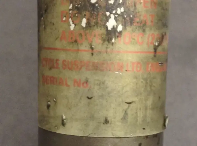

It's a better image than I got before, for MrOX..
I did a pencil rubbing too, I think it's M91063(or 5)004

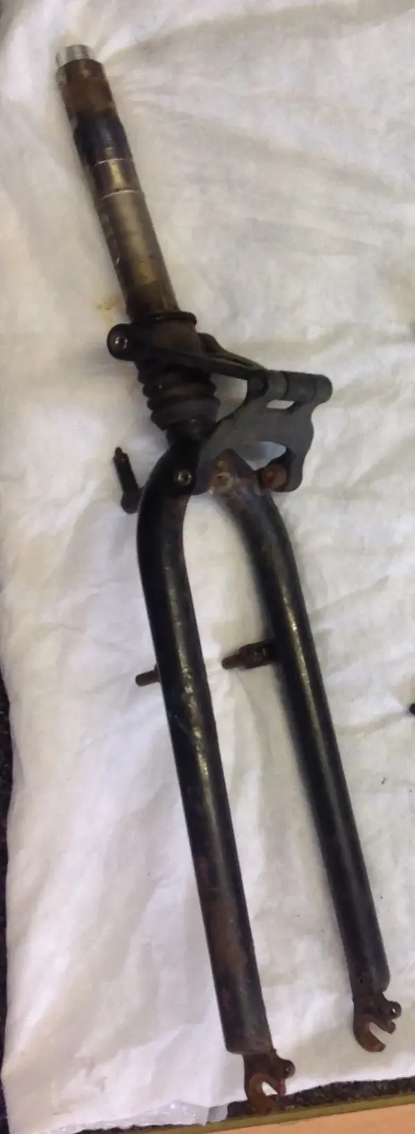

It's hard to make out the fork serial, other than parts of. The barcode has faded out too. Just under the "red serial no" font, there's hand written scribe just visible, that looks to say ptype 3/004 but I'm really squinting to see it and it could say something wildly different.
As you also mention, the forks on this one are straighter of blade than all the others you kindly found so far, also they've always been black I think, no trace of the fushia accent colours underneath or the oxide primer, as appear around on the others.

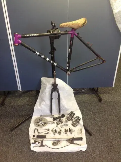

As Recieved, from David all packed and squared away with the greatest of care, total gentleman of the forum. My plans are a little different with this one, to yours Boy'o'boy. After removing the seatpost (it's having a looong soak!) I'm going to treat the rust and touch up the primed areas as best as I can, repaint the forks and rebuild the frameset with original decals intact. I like that it's had a life and shows it! The BB is out now and is very serviceable. I'll put some bits on I have squirrelled away from here, inc some Ti Sakae Bulges and a TCO post I have, use the XT 730/732 wheelset that David sent with, same on group.

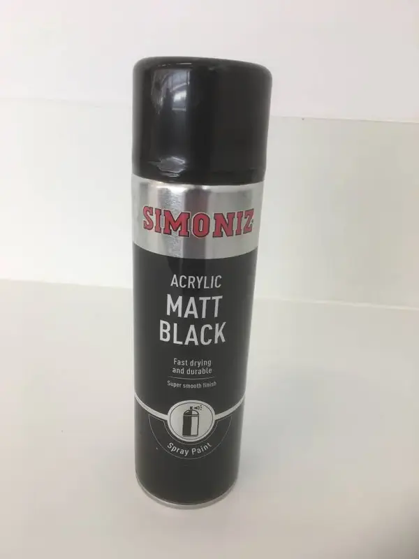

That fork paint colour looks a good match, for the black of the frames, could I ask what you're using Boy'o'boy, will blatantly copy to use on my forks and to touch 'er up, ooer!

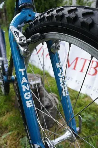

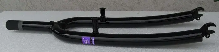

The frame number (if you go with it as a 3!) and the serial number of the fork matching (especially with the straight legs) -I'd say yours is a prototype, or at least the earliest production ones. Maybe even a pre-production?
The serial number on my Browning forks doesn't match the frame number. I think mine are the 'standard' production ones.
- The straight legs on yours look very much like a modified Tange Big Fork.
- The curved legs and drop outs on mine look very much like a Tange Super Big Fork.
(I've added some pics to show this)
I reckon the 'Big Fork' came before the 'Super Big Fork' and what was available at the time off the shelf to modify into the suspension fork / or was available to modify supplied by Tange.
What does the collective think?

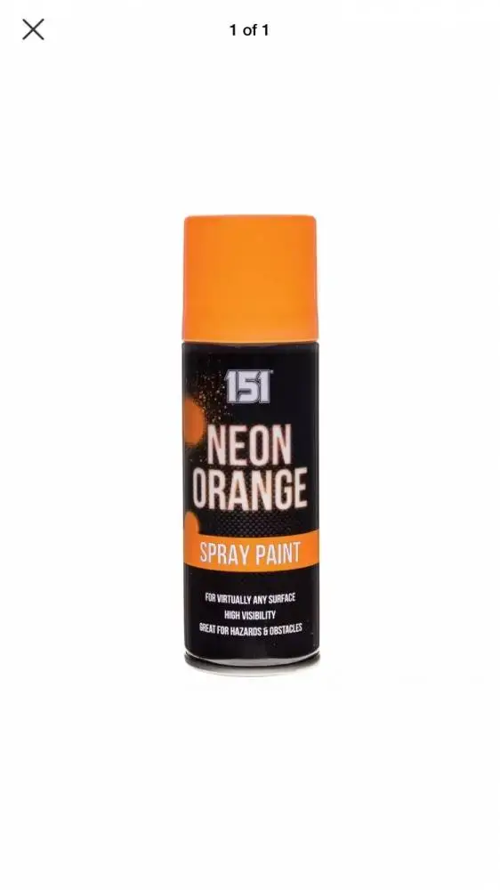

Colour wise. Here's the Matt black and Neon Orange I've used / will be using.
