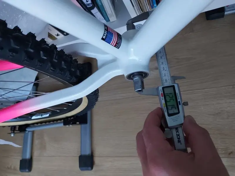

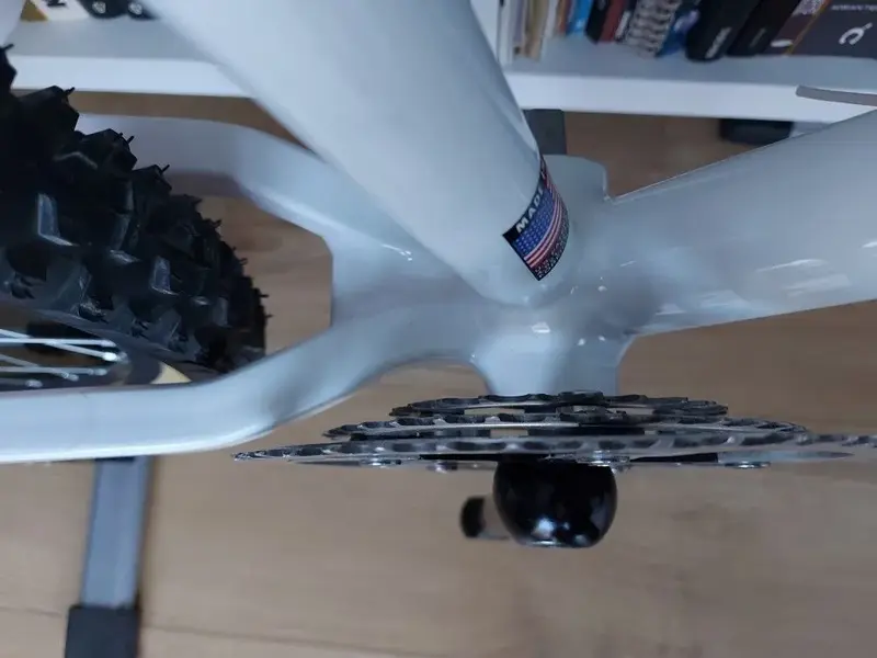

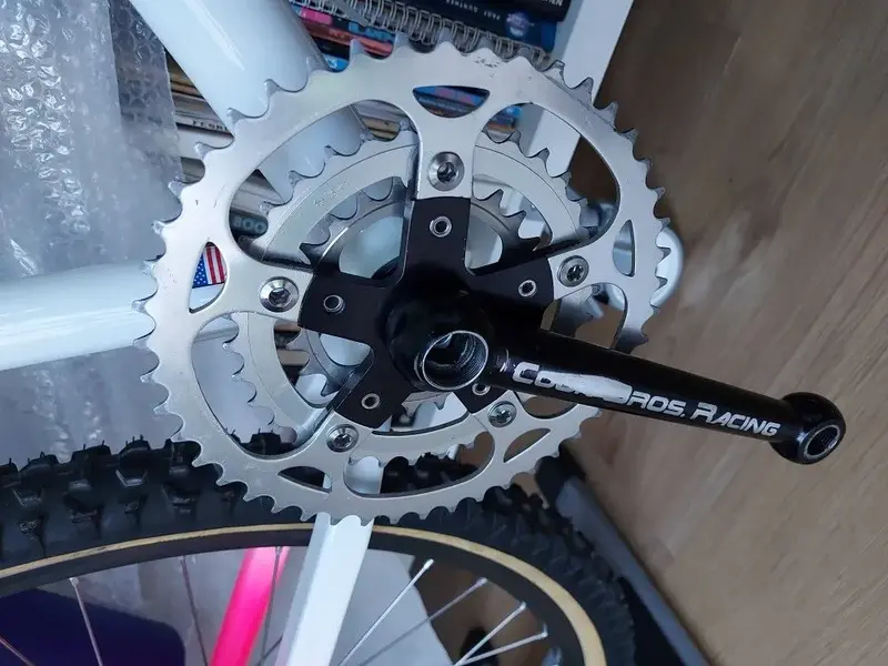

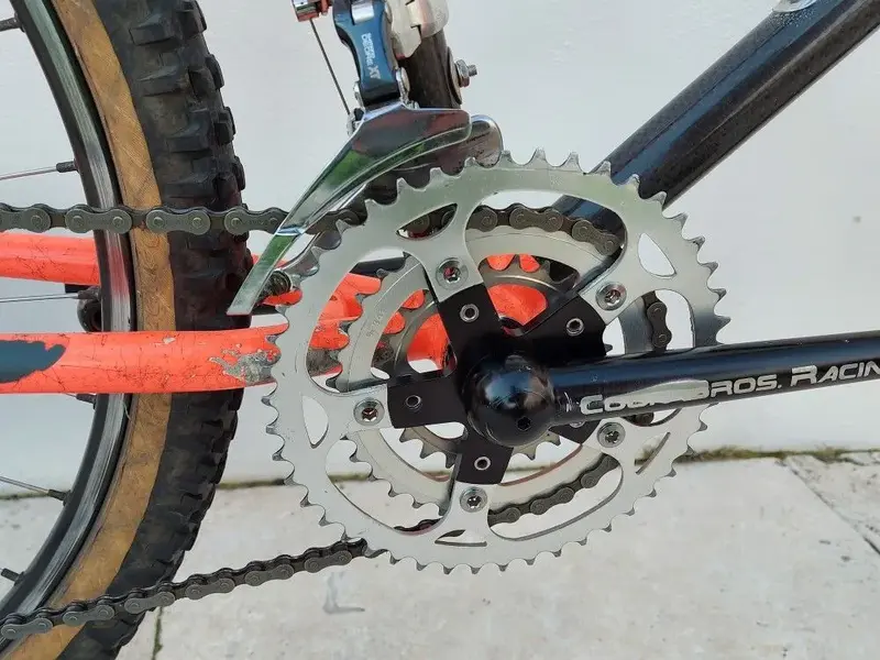

Good question Pete. This is why I'm thinking along the lines that the 1990 Trek 8900 must have used a really long bottom bracket spindle... another one of these perhaps unique to top end spec things?
For reference, I can't guarantee that all Cooks cranks will go along these lines and every manufacturer will be doing something different!....... but if I put these very same cranks on the Klein ( I have another pair much nicer for this) the bottom bracket spindle is 125mm...... and the chain set fits perfectly with no need for a smaller outer chain ring and has plenty of chain stay clearance.
As always..... here's some pics and the digital calipers out of the box again! :LOL:

Hi all.

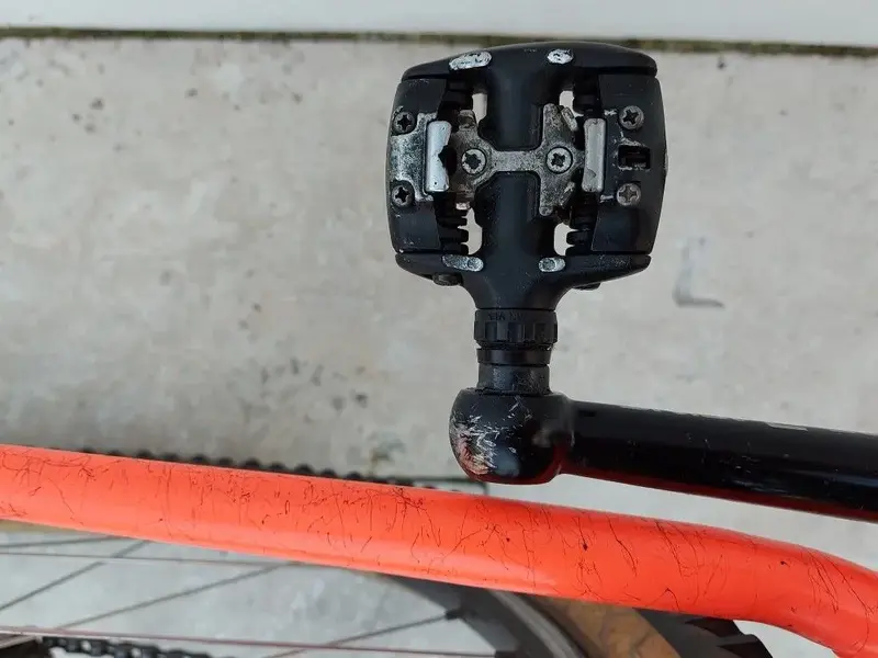

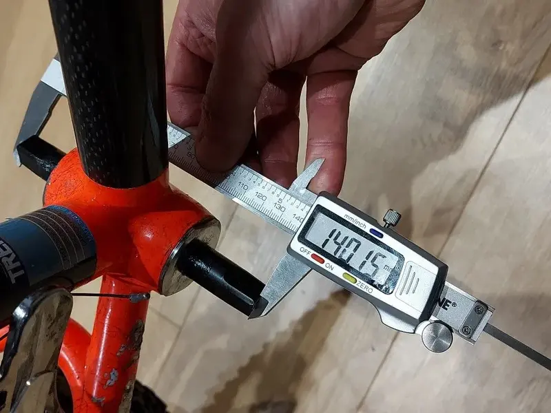

So, finally managed to get the cooks cranks fitted after quite a bit of trial and error.
From my last post,The stronglight bottom bracket axle was still too short for the chainset to clear the chainstays when fitted, so I was awaiting a 140mm Campagnolo one to arrive from the US.
I wasn't sure how it would match the cups of the stronglight, but didn't have a lot of choice when it came to brand as there isn't much available. :? - but it went in OK.
Will need to test ride these to see what they're like.... the DX may go back on if they seem too fragile! If they remain, I think black chain rings would aesthetically look better. Suntour XC pro thumb shifters and mechs are probably the next on the swap over list, but in the meantime- ride and enjoy. ;)
Here's some pics.... and another outing for the digital calipers!
Cheers.

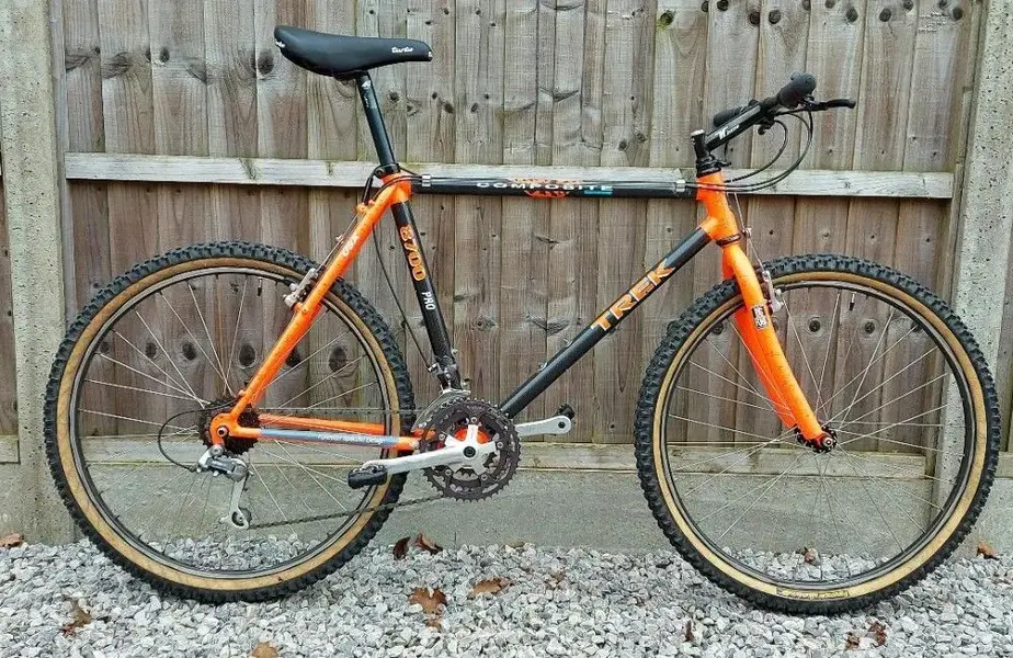

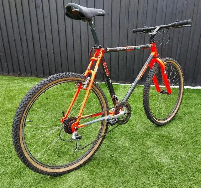

Firstly, thanks to all that voted the 8700 as August 2020's BOTM.
I was also chuffed that this got a few BOTY votes against some big players. Thank you to all that voted. :cool:

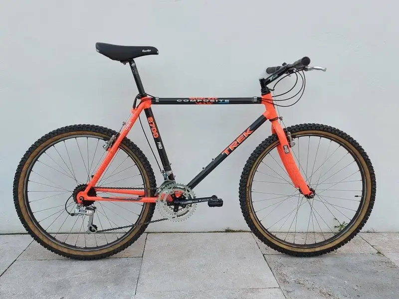

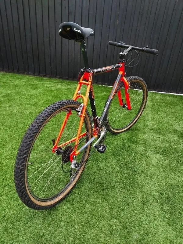

So, after a couple of outings on the Cook's, it soon became aparent that although the bottom bracket axle was now the correct length, the tapers weren't a good match for the Cooks. The non-drive side was continually working loose. So, I've reverted to catalogue spec and gone Suntour XC Pro (non-micro drive) Chainset and Mechs. I've also added XC pro thumbies and Dia compe SS5 levers. The only part I'm missing now are the Dia Compe 986 cantilevers.
I'm still running the DX canti's for the time being until I find these brakes. The grips have also been changed out for Odi attacks.
Also replaced the tatty Chainstay protector with one from Velo decals. Unfortunately, when I applied it - it turned out to be grey rather than black that I thought I'd ordered. It looked black through the application paper, so when it was revealed as grey, I was slightly gutted. Awaiting a correct colour replacement but for the time being, I'll keep this in place.
Rides really nice and with the added benefit of no longer having to attach the child seat as the youngest has out grown it now!
Any leads on black 986's greatly appreciated.
Here's where I'm at the moment.
Cheers.
boy"O"boy
