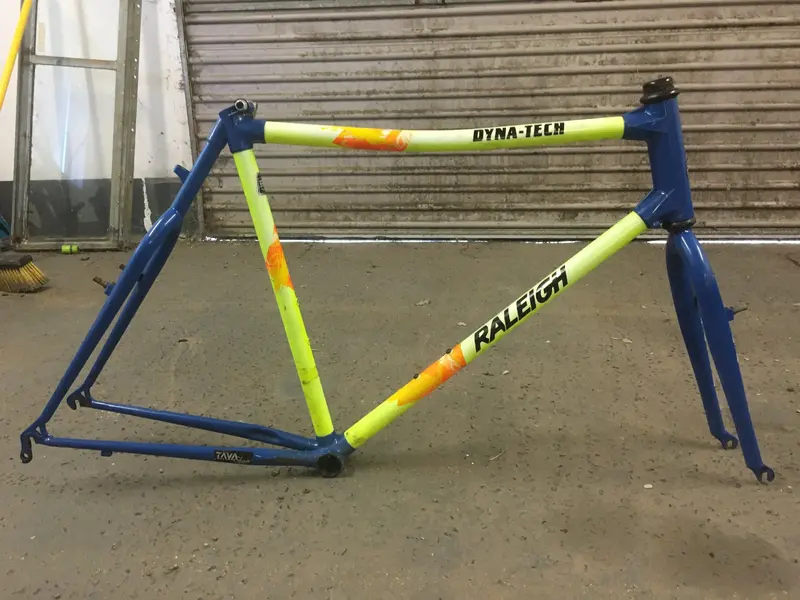

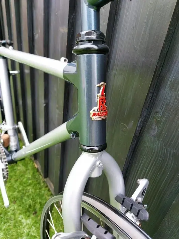

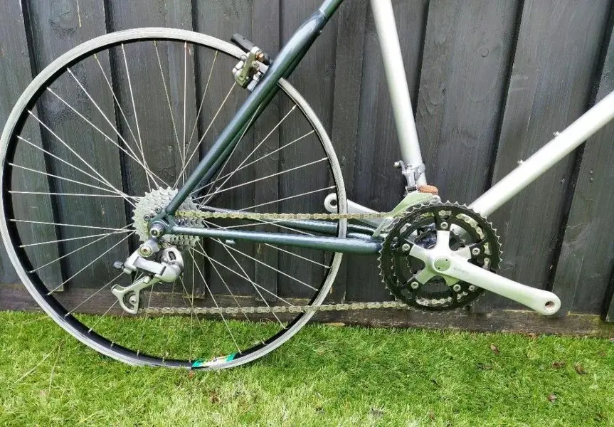

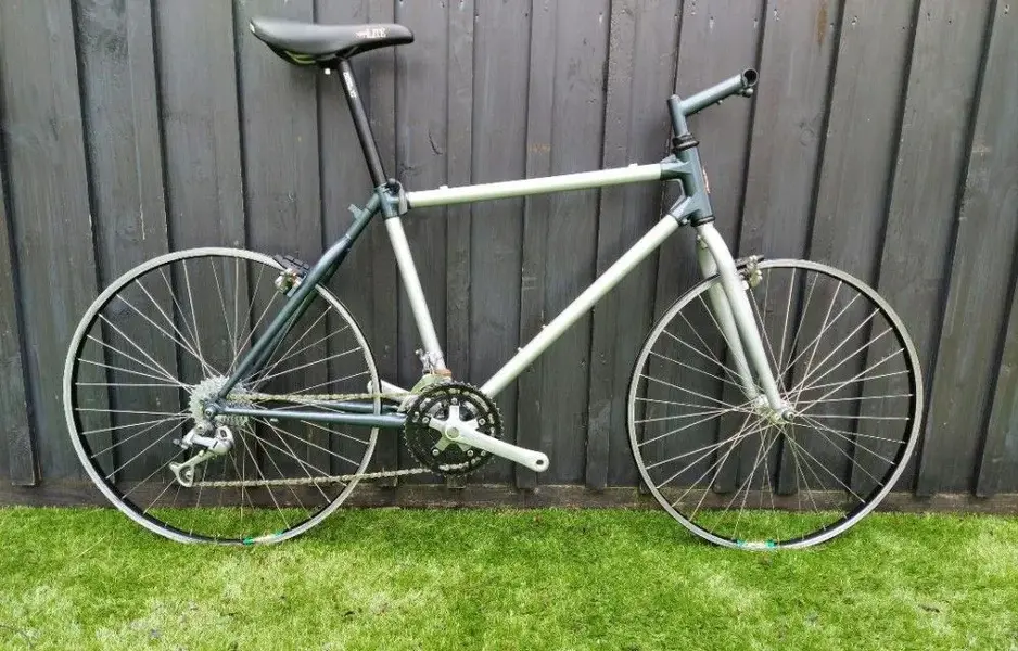

Finally progress has been made (largely thanks to a forced isolation :roll: ) and the build is well underway.
The frame was rubbed back, primered and painted in the colour matches during December. I was fortunate enough to get a professional clear coat applied and baked on the last day of business by tagging onto another job in the paint booth.
I let this all settle over the Christmas break, and spent my time building the wheelsets for the Dynatech and Stumpjumper. The wheels for this are Araya RM20's on M732 XT hubs.
Parts such as the Vetta Lite saddle and the NOS M730XT seat post were sourced from the US via eBay.
Other parts such as the XT thumbies and M730XT Chainset were also sourced from eBay. The chainset needed a considerable amount of polishing to get them up to parr. Unfortunately, the Chainrings are knackered so i'll be on the hunt for a decent set of black chainrings from a DX/XT chain set - the ones that have the orange SG decal.
Another part of the build to source is a Rockshox Mag21 crown and steerer.
I've sourced myself a decent one but disappointingly when I went to fit it today, the actual measurement was 10mm shorter than the description :facepalm:
So, i'm on the hunt for a 1 1/8" 155mm crown and steerer. The gold legs of the Mag 21's looked ace on the trial fitting though.

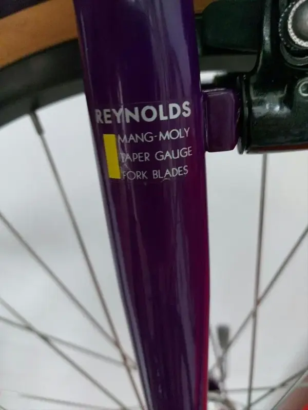

I also need to contact Gil_M about getting the Odyssey decal for the top tube making up and the Reynolds decal for the fork legs. Fortunately - I've got the Endeavour for reference.
One decal that was preserved during the repaint was the holographic frame number and tubing identifier on the bottom of the seat tube. this was clear coated in the final coat to preserve it. I don't think anyone makes these…especially with your own serial number.
Here's some Progress pics.
More to come.
Cheers.
boy"O"boy

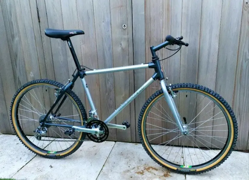

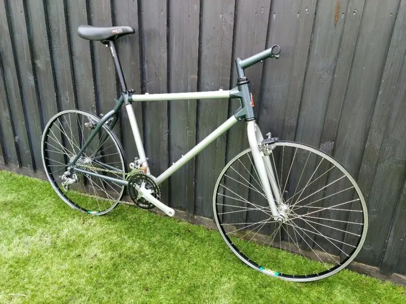

The bars, shifters, brake levers, and ODI grips now added. Now needs cabling up and sorting the niggles.
Ignore the wheels and Tyres. This wheel and Tyre combo is destined for the '89 Stumpjumper - just added to show what it looks like on amberalls.
The actual tyres are on the way - narrower Smoke Lite compe's will be better proportioned on this build. The Terra one tyre on the front leaves very little clearance, but they are great tyres - foldable and very easy to fit. Looking forward to fitting another pair of these on the Trek 8700.
Once the correct Crown/steerer is sorted for the Mag 21's - I'll add some more pics. They did look as good on this build as I thought they would though!
Cheers all.
boy"O"boy

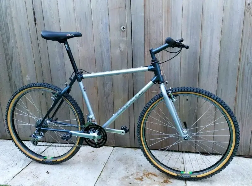

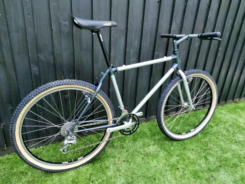

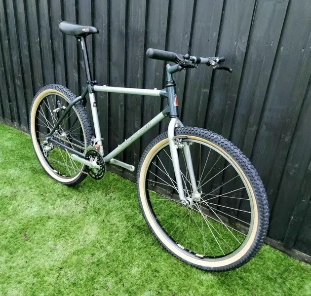

I've moved the build on slightly today….
-The RM20's on M732 XT hubs are now shod with Panaracer Smoke Lite Compe's. The narrower size of tyre suits the frame much better.
- The brakes are now cabled up but I'm waiting for the gear cables to continue.
- NOS Shimano PD-M525 pedals fitted.
Still to do
- Get the Odyssey top tube decals made up. Also need the Reynolds decals for the fork legs.
- Source black SG 46/36/26 chainrings (with orange logo) to replace the knackered ones.
- A longer steerer and Crown for the Rockshox Mag 21's has been purchased. I've had to buy 4 to get the one I needed though! Once these arrive, the Mag 21's will be fitted.
Here's the latest pics.
….Then onto the Stumpjumper to get that ready for a repaint.
Cheers all.
boy"O"boy

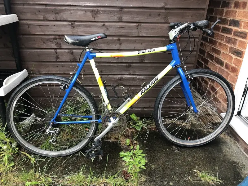

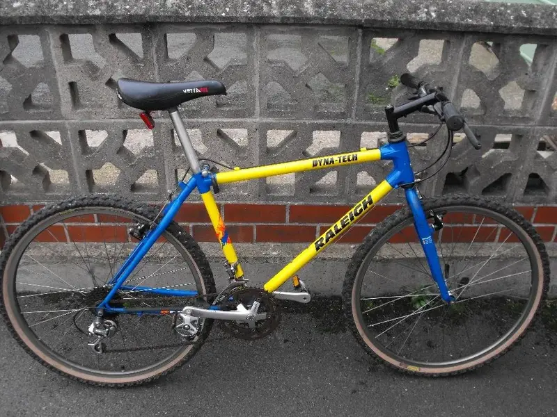

Here's some pics sourced from here and Google of the Dynatech Team 2070.
Have a look at the similarities between those and the Endeavour. There's also more than one example too!
Good luck!
boy"O"boy

no holes for the panniers!
Of course - they’re the same frames! (Apart from the dyna curve) and I can’t notice any other differences between the encounter and endeavour frames apart from the pannier eyelets
I owe you a drink man! Right now I think I need one as after ages trawling through the Dynatech thread there’s no other Endeavour except yours! And all manner of retro bike search And searching google Bing Yahoo and DuckDuckGo - nothing - except for your one!
And have emailed Steve, let’s see if he replies!
