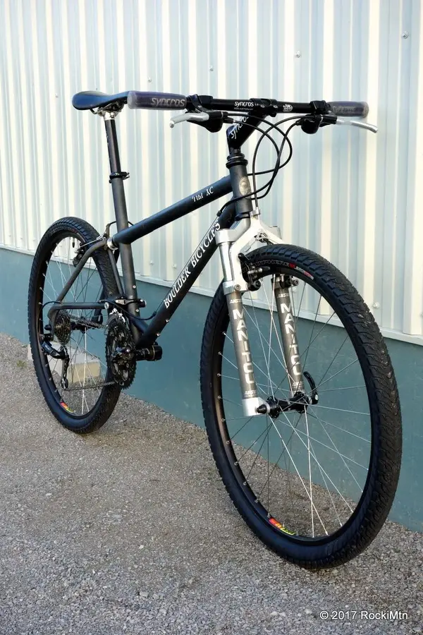

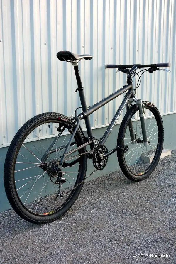

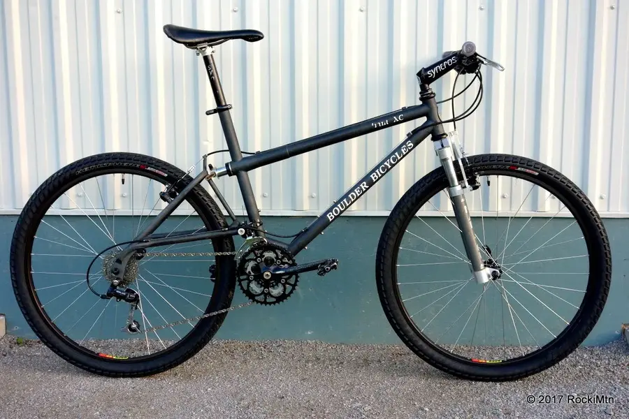

first build draft… i can ride the bike, but barely. saddle is way to high for me. i need maybe 1/2 - 1" lower for me to comfortably ride on pavement. i'll need the seatpost even shorter if taken on trails. :P what to do? trim the uncut Syncros seat post i have or try and source a shorter one. :? what have other Boulder owners done?
also i'll definitely need to up the teeth count on the compact inner to 24t and an outer 46t chain rings. :(
lastly think i'll swap the fork over to a Judy FSX once i sort out springs to get it up and running, and a threaded steerer/crown to install it.

Why not find another one that's already shorter to use while out-and-about, and save the uncut one for when the bike is parked on show ... ?
i'm considering that, but 28.6mm isn't a common seatpost diameter. if i could source a second Syncros seatpost that's both cheap and maybe already trimmed down, that would be ideal.
The irony - I sold a first gen. one in that diam. to someone in New Zealand about six months ago ... but, while well used, it wasn't cut at all ... still got $85. (can) for it (is that cheap?)
