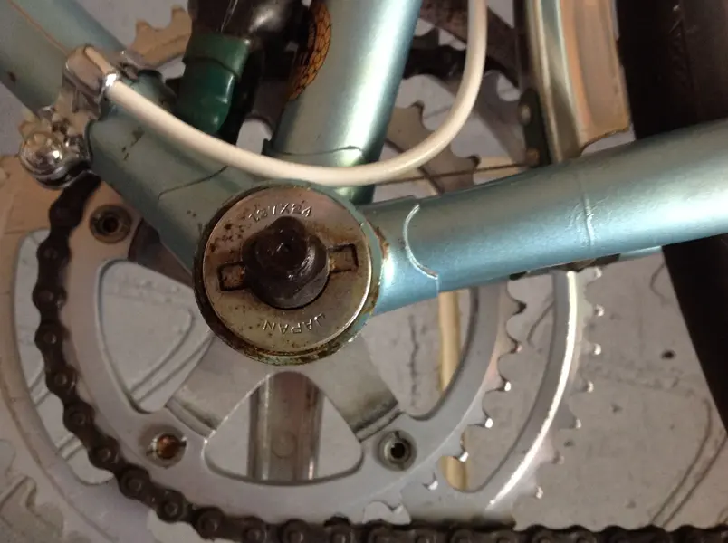

I am trying to overhaul my crank bearings but on the adjustable side I cannot seem to find a tool that fits the two square slots. There are many 2 pin spanners around but the Park tool pins are 29mm apart and therefore too wide. Also, being square slots and not holes I cannot see how a 2 pin spanner would give a snug connection in any event.
Has anybody seen this this type of fitting before and if anyone can provide any guidance regarding an appropriate tool it would be much appreciated.

What bike is it?
Personally I've not come across this type before, I'll be surprised if someone on the forum hasn't tho!
I assume you've removed the lock ring if so try plenty of penetrating oil & maybe try tapping it round using something soft like aluminum or brass!
Other than that this type of spanner may do the job, available from Park Tool for example.

Thanks for that. The spanner you show is the HCW 11 and would seem to be the necessary tool for these slots; I don't know why I didn't notice that :roll: Ideally however, I would want the prongs mated with the 36mm box end of the HCW 4 wrench then I would have both sides covered but I guess one can't have everything!

Should have added that whilst it appears that the HCW 11 is an appropriate tool it would be nice to hear from someone that has actually removed this fitting before.
I've come across one before, but mine wasn't seized. I took the lockring off and then just tapped it out with a hammer and punch to get it going and then just undid it using the punch as a winder- handle, if that makes sense
Thank you, I guess it is going to come down to that.
It does seem a bit odd though that these were mass produced fittings 40 years ago and one would have thought a specific tool existed?

I have gingerly tried tapping with a punch and hammer and nothing seems to want to give so will probably keep looking for an appropriate tool. I had a quick search for Sakae/Silstar removal tools but all searches seem only concerned with crank pullers.

A punch/drift is entirely appropriate to loosen these off; Just keep a very flat angle when you tap it and it is highly unlikely that you'll cause any damage to the parts whatsoever. I assume you'll change the bearings while you're there?
You'll be amazed when you clean up the threads how easily it will wind back in.
