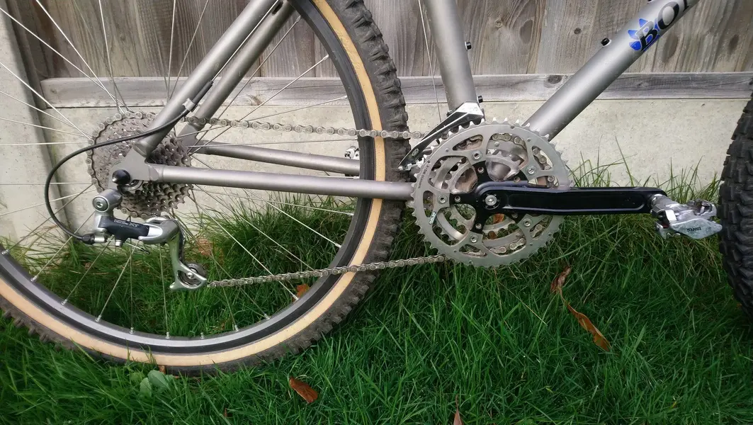

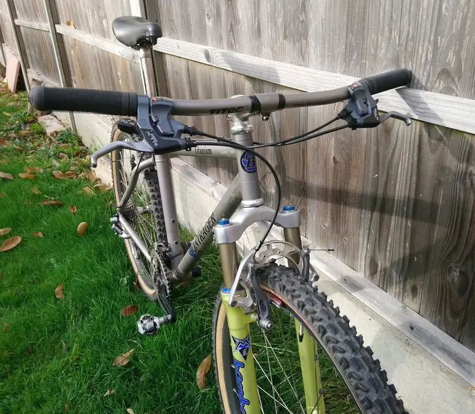

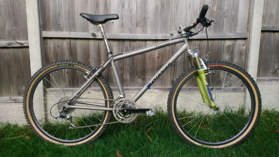

Been playing with this again, swapped the brakes for some Avid Mag V's with some XTR M950 levers/shifters, fitted an XT rear mech for the time being. I plan to fit an M950 eventually. Also swapped the pedals to SPD, nothing wrong with the Onzas just my only Onza cleats are on summer shoes and it's started to get cold! The Sachs stuff and Maguras will probably find their way back to the Privateer. DSC_0212.JPG DSC_0214.JPG _20211106_111822.JPG _20211106_111847.JPG
