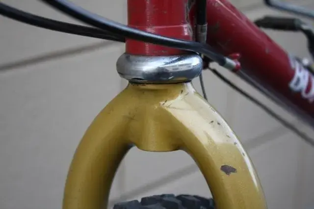

bontrager uni-crown forks are brazed, not tigged. brake bosses are different than what you have also
but those are the old fb'd bontrager forks, right? not the ones on the Privateers?!
