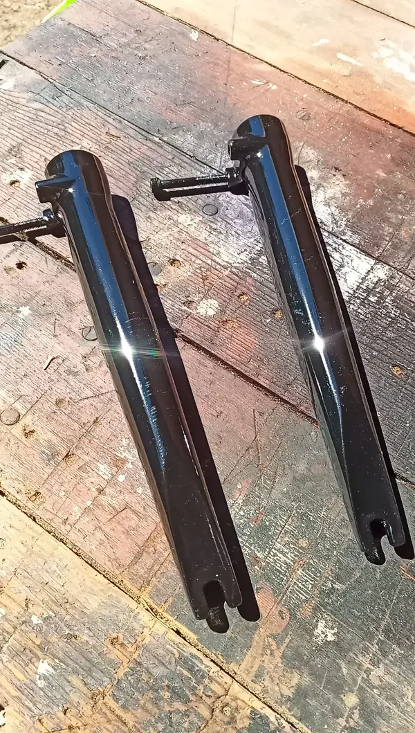

Here's the legs after primer:
Here's the legs after gloss black enamel and clear coat enamel. Photos make it look like the legs are scuffed, but they're not, I guess it just caught the light that way, or it is dust (it was breezy when I took the pics, lots of pollen in the air).

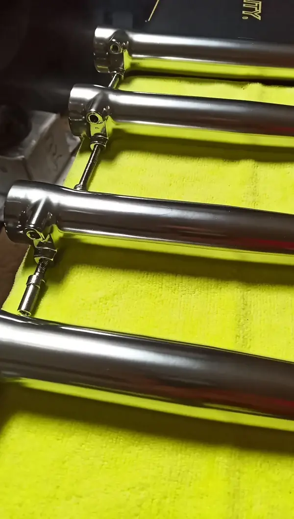

And here are the legs after Mirror Chrome application and hand buffed with a microfiber cloth:
I'm contemplating hitting the legs with another coating of clear coat before I consider getting the gold tinted coating on. I'm doing trials with Gordon Tarpley's usage of Liquitex Acrylic high gloss varnish mixed with yellow and red food coloring, on clear plastic containers. It goes on with a brush, and I've been using a high quality Purdy nylon/polyester brush, but it still leaves streaks and bubbles, and the coloring isn't quite right. So I'll try using my air brush with this mixture on test objects next, but if that doesn't work I'll move on to trying Kustom Canz candy lacquer in either yellow or gold. And if that doesn't work, it will be time to try mixing up a batch of SEM California Gold. Soon as the weather settles down over here, I'll be back at it posting more results.
