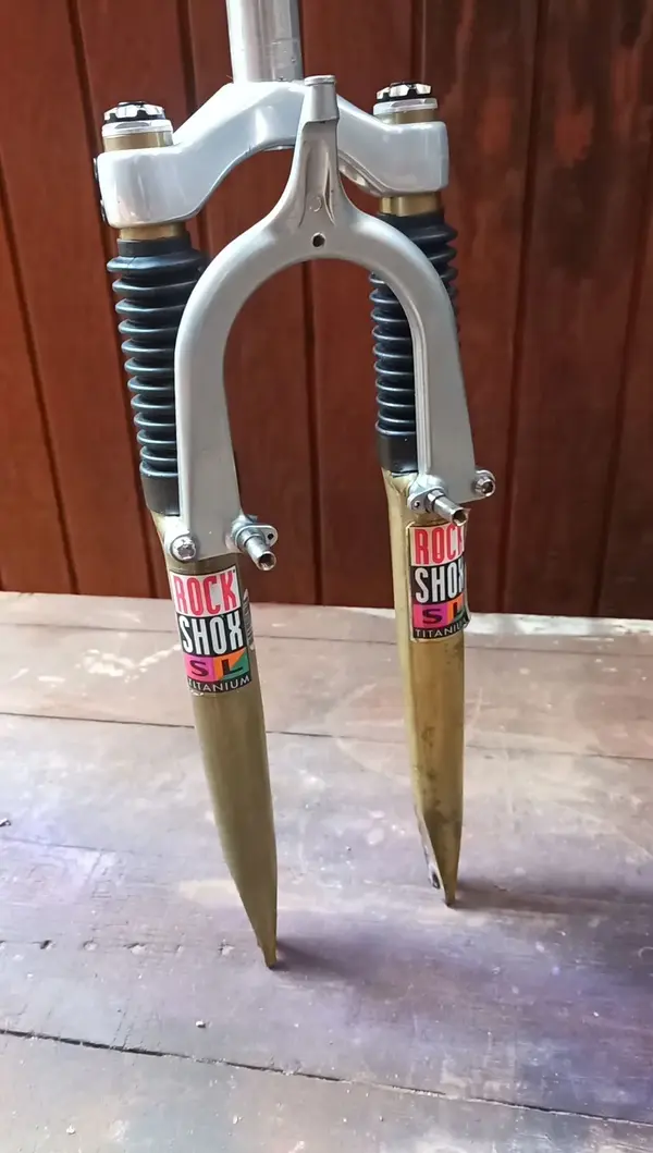

Well, while I'm waiting for the frame to come back from the powder coat shop (sounds like it will be ready Tuesday!!), I'm starting on refurbishing the Mag 21 SL Ti that will sit on this frame. It's got the typical leg cancer, which I plan on remedying by figuring out how to refinish the gold lacquer. You can see that it is in need of some love...

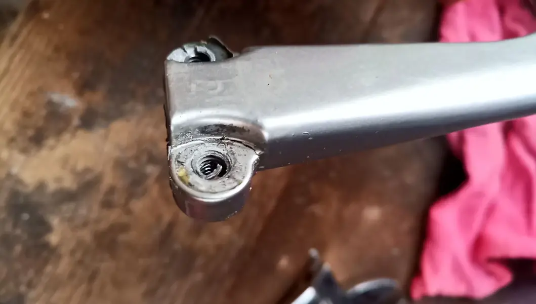

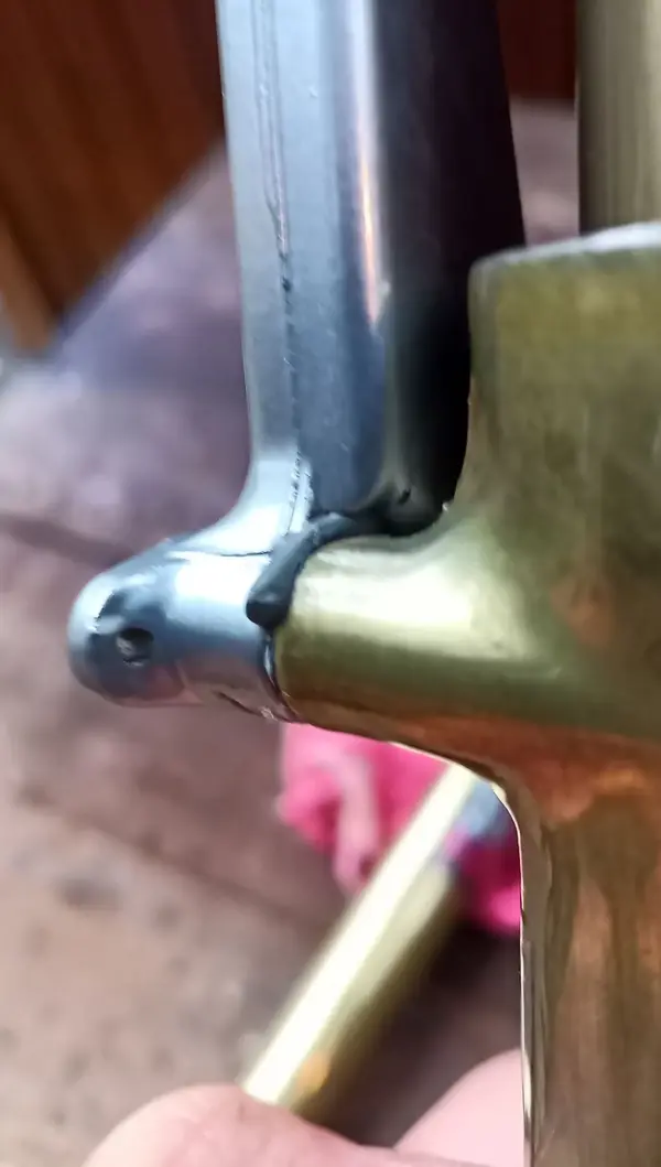

Upon disassembly, I discovered that the prior owner did not fully disclose its condition to me in the ebay sale (big surprise!)....the crown bolts are not Ti (as I said before, I used to own one of these and I recall all bolts being Ti), and both of the threaded holes in the right fork leg were stripped at one point, and the previous owner used some sort of epoxy or lock tite to secure the brake post and bolt into the leg (and the bolt was chromed steel and not Ti as well, although the post was still Ti).
I think this is some sort of epoxy and not locktite, as you can see the hardened gray "glue" that had oozed out of the fork leg once upon a time. The other result is that the bolt hole through the brace was cracked. Not sure if I will try to fix this or buy another brace from somewhere.
The oil definitely needs replacement, but the legs appeared to hold air. I am trying to assemble rebuild parts for this, including possibly a long travel kit (again, had this once upon a time and liked the added capability, and I used the bonty with it on tight single track in North Carolina without any handling issues despite the slight changed in geometry).

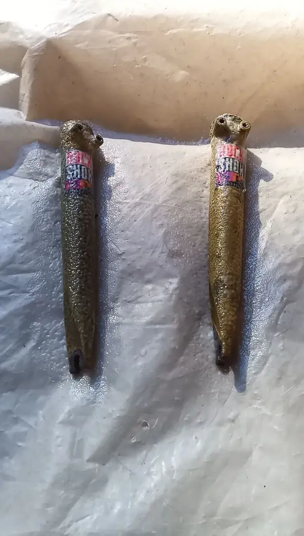

OK, well the original powder coat was pretty thick, so it's taking more chemical stripping than anticipated, and the painter had to order more "just orange". So, looks like the frame won't be ready until early next week. But that gives me time to keep working on the mag 21s, which of I've hit with Jasco's stripper to get the old lacquer off. Will attempt to polish this weekend if the stripper succeeds. IMG_20220122_130533_2.webp

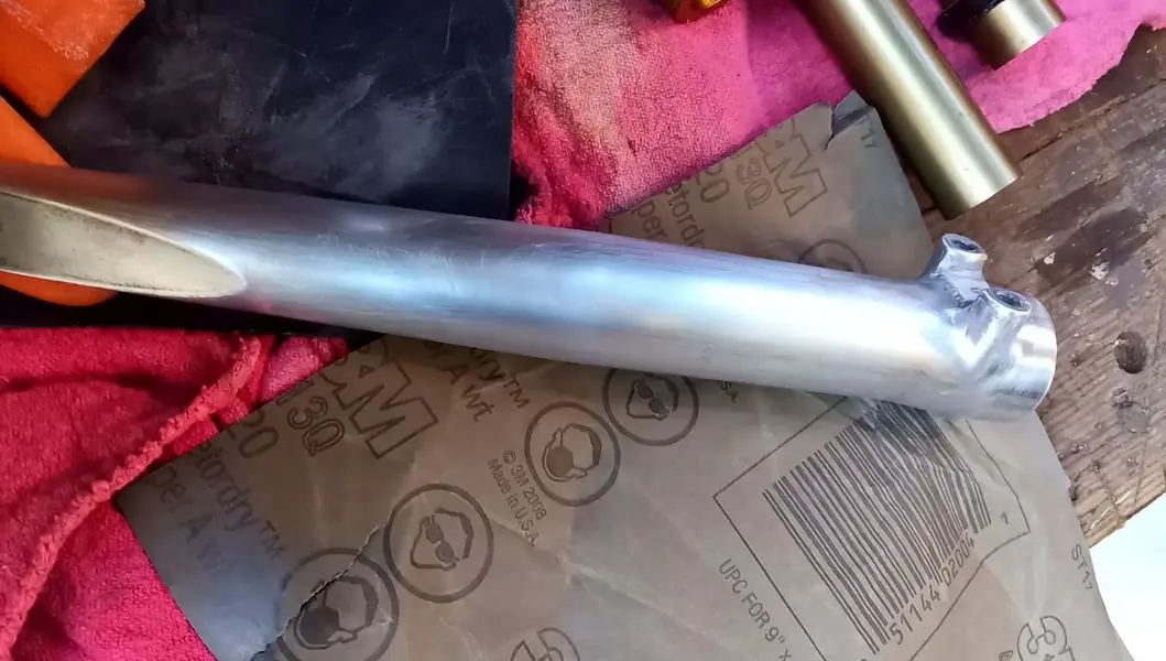

Stripper has succeeded. But, the worm-trace cancer and oxidation remains on the legs, albeit without any trace of the lacquer. So, I got out the fine-grit sandpaper and started hand sanding, starting with 320 grit. Now magnesium is quite soft, so starting with 320 worked well to remove the remnants of cancer and oxidation. You can see below part of the leg (mid section) has been sanded, while the dropout is unsanded. IMG_20220122_152130_2.jpg
A fully sanded leg with 320 brings back the native silver tones, but leaves a slightly dull surface with scratch marks from the grit:

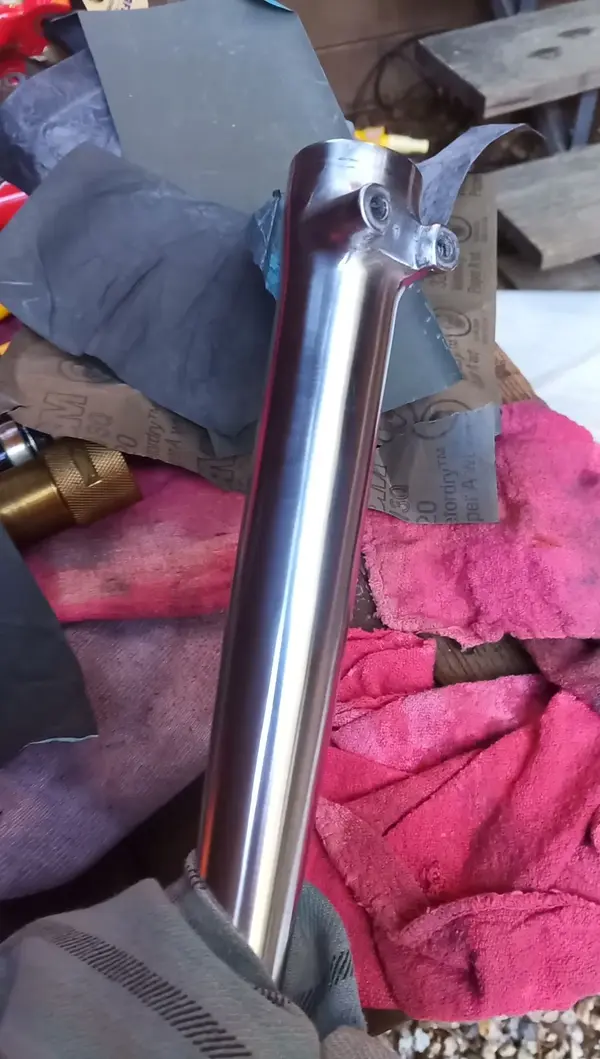

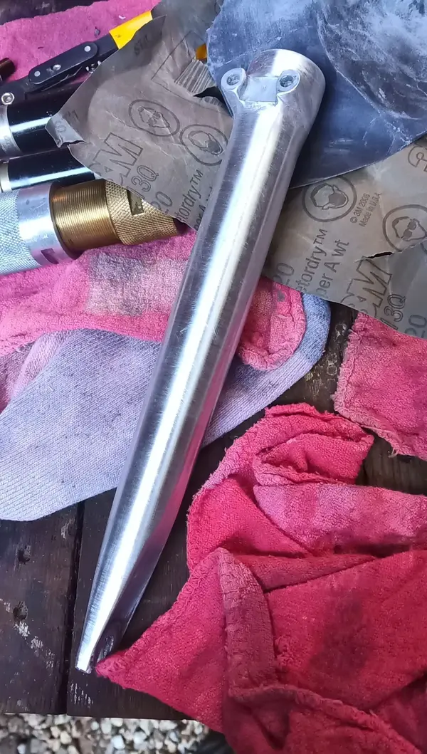

Proceeding up to 600 grit, and starting to sand circumferentially instead of lengthwise along the leg: IMG_20220122_153352_9.jpg
And then moving up to 2000 grit and rub down with a dry rag gives a pretty damn nice polish, but not quite mirror finish:
