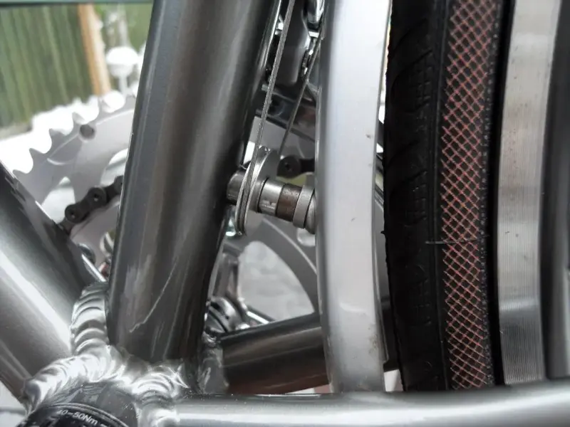

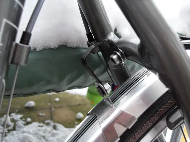

I have struggled to get proper mudguards to fit on my cyclocross bike which I am using as a winter road bike. It is a strange design with eyelets for racks front and rear but not enough for mudguards. The bike has mini v-brakes fitted which means the standard canti brake boss cannot be used.
A bit of head scratching and raiding the nuts and bolts reserve came up with this.
Parts used:
chain keeper from a singlespeed chain tensioner.
2 x bottle cage bolt spacers
adjustable spacers from a v-brake
1 x cleat screw
5 x bolt cage bolts
Very pleased with the results and just wish I could get out and ride the thing.

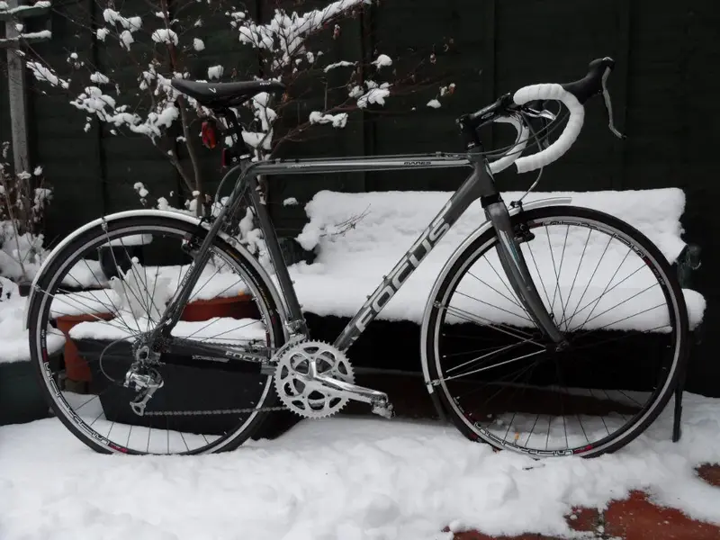

whats that white stuff?
