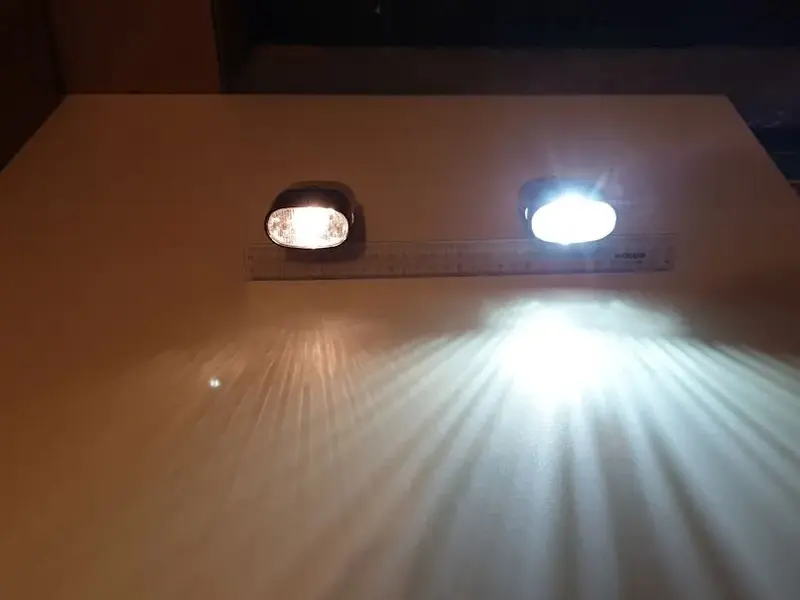

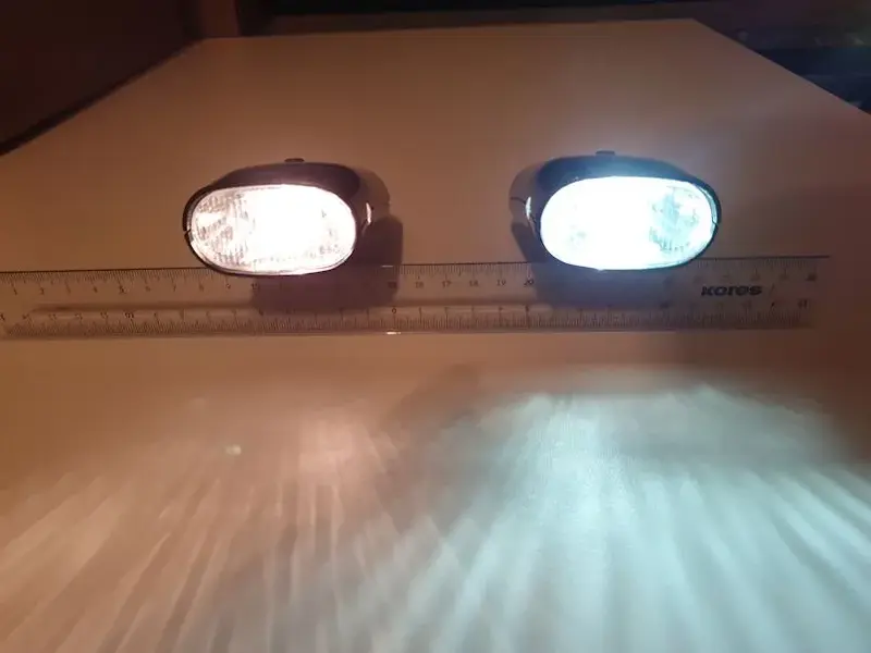

Depending on which halogen set, it can be pretty easy. I run the classic Cateye Halogen HL500 headlights on my bikes, and did replace the bulbs with LED ones.
The bulbs in the HL500 use the P13.5S socket. The original Halogen bulbs are marked as 2.5V and 0.5A, so they're 1.25W. Given the 3V that the batteries push when full, I suspect that their actual consumption is about 1.5W until the battery is starting to get drained.
I ordered a pair of 0.5W and 1W bulbs (I didn't want to buy from Ebay, I just wasn't confident about the accuracy and quality of the cheap Chinese LEDs) that worked with 2.5-3V. The lights work just fine and due to the reduced wattage the C-cell batteries will last a lot longer. The light output is also increased from 11 lumen for the halogen, to 22 and 65 lumen depending on which LED I install.
Some pics. I think it's fairly obvious what's what.
I normally have the 0.5W LEDs installed on my bikes. There's plenty of light over here even at night, so the 1W setup is complete overkill.
