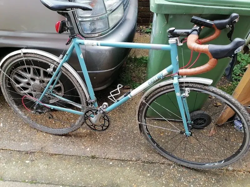

*and heres a crappy pic of my light, it is very nicely built nad hasnt done anything wrong yet. **and some of the cheap crappy stuff has held charge for nearly 18 months
