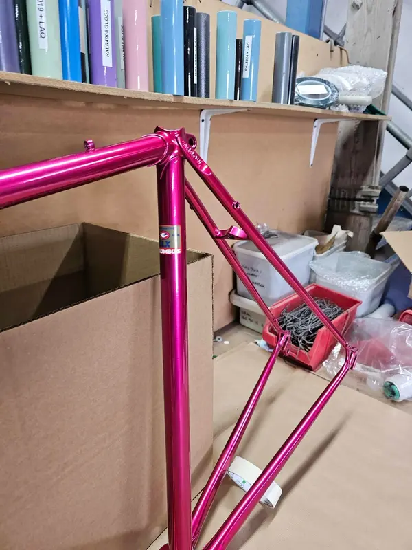

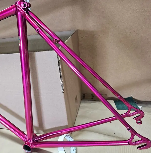

Thank you for the advice…the stays look somewhat thin…SLX tubing see attached photo.
However, I don’t know what you mean by ‘dink for a triple’? What do you mean? Pardon my ignorance on this.

Frames expecting a triple often had a deep pressing in the chain stay to allow the inner ring closer to the centre line.
Otherwise of course adding an extra ring would move the larger 2 chainrings 5mm+ out. Not ideal if you started with a correct chainline.
The chainstays can be attached to the bb with varying spacing, it depends s on the bb lug with a lugged frame like this.
Given its a late lugged frame with narrow tubes though, I would think the shorter bb would be the best fit.

I don’t think the frame has that as it is road frame and wasn’t expecting a triple in its lifetime!
Currently I have a Shimano Tiagra road triple with an external BB and there aren’t any problems.
